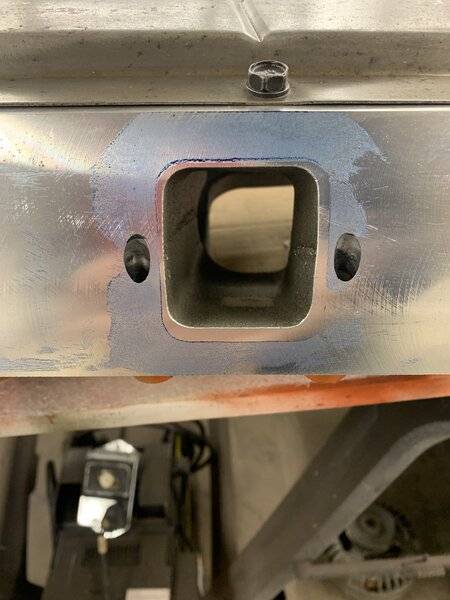

I checked the intake fit once again and this time i used a very light coat of prussian blue
on the face of the heads.
Next I dropped the intake on using studs and no gaskets and torqued to 30 inch lbs.
using the proper sequence.
Here’s what it looks like.
Hmmm - not sure what to think of that. What do you think? I guess 30 inch-lbs on the bolts shouldn’t be enough to distort the intake without gaskets.
I wouldn’t think 30 in-lbs would distort the intake. It’s for sure a bit tight tighter at the bottom of the ports keep in mind it was a very thin film of blue so we’re more likely seeing less than a thousandth or two of difference. I wanna think it would be good to be a bit tighter at the bottom vs tighter at the top I have tried a to fit a 1.5 thousandths feeler gauge at the corners top to bottom but it won’t go so i think it’s a pretty good fit.

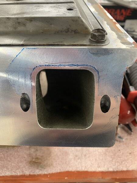

Here’s the intake side I’m wondering if there’s a need to port the intake to match the head ports?

Be cautious matching the intake to the heads. Sometimes it hurts more than helps. In addition do not port match the exhaust ports to the header tube. Gasket match yes, port match to headers no. Darin Morgan said so is my only backup to that statment.

The best way I know to verify intake fitment is bolting the intake down with no gaskets finger tight and use a feller gauge to map out the gaps. Then mill or adjust gasket thickness accordingly.

Thanks for the info I do have some brass set screws to do the idle circuit calibration if i need them. plan to start with the bypass idle air bleeds first. I’d rather not do any porting on the intake and i have used the feeler gauges to check intake fit corner to corner and top to bottom on the intake flange to head.
Agreed on you may hurt more than help by trying to port match.
If you open up the manifold at the face you need to open up the entire port to keep taper/shape consistent (I did this on mine and it took about 15 hours).
You don't just want the end of the port bellmouthed to match the head, better off leaving it smaller/as-is.
