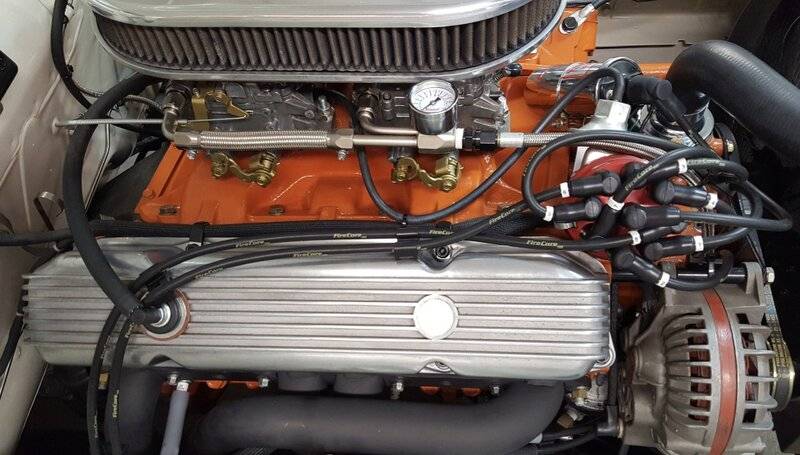

I been thinking quite a bit on the edelbrock idle mixture screws. I know that the somewhat norm is to start with them 1 1/2 turns out from closed but in my pondering wouldn’t that be too far out when running as a dual 4 setup? It makes sense to me that you would start with them out half of 1 1/2 turns with two carbs 3/4 turn out and tune from there.
Doesn't really matter where you start, just get it to temp and adjust for max vacuum.
Do the 1-1/2 turn out on both carbs for a base. More than likely you'll find that the front and rear carb will be set the same when all is tuned in. I used a vacuum guage and tach when setting mine. Did the rear for highest vacuum and rpm then the front. Went back over them again and all is well.

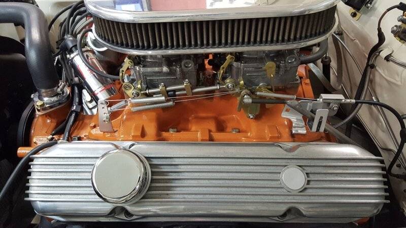

When initially tuning these carbs I had them setup with the progressive linkage and I noticed a high temperature with the front four cylinders. (Using a IR temp gun) This was telling me there was a lean condition with the front carb. After opening the front throttle plate just a little (using the idle stop screw) the front cylinders returned to a normal temperature. I changed the linkage to one to one and have both front and rear carb throttle plates set the same at idle.
Don't forget that having proper timing set is very important when tuning any carb whether one or two carbs. You might have to go back and forth a couple of times between the timing and carbs before it all gets dialed in. You'll get it.

I do have them setup as 1 to 1 on the linkage I’ve also checked the temp a couple of times on each tube my readings show the outside cylinder temps to be just a few degrees cooler than the middle 2 on both banks. I have played with the timing some and have it at 18 degrees initial right now with vacuum advance unhooked I did connect to ported vacuum last night as per hemirunner’s recommendation.
