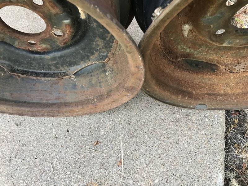

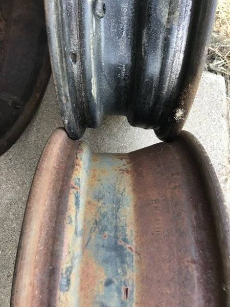

Not all factory 14" Mopar wheels fit the factory small rotor discs either. The wheel needs clearance for the caliper.
Top 14" will fit, bottom 14" hits. ( Yes they're different widths, I've tossed or sold all my 14x5's that didn't fit, and I had many.)
Front of rim...............................................Back side
The style steel wheel on the bottom will not fit disc brakes.,,,, doesn't matter if 14x5 , 14x5.5 or 14x6
Look at the shape on the inside of the rim.
