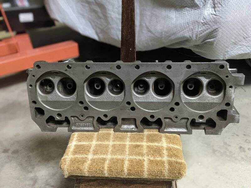

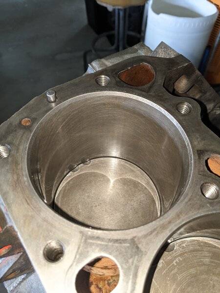

I bought the shortblock on CL, and it was assembled when I picked it up. I also got a pair of ported 906 heads (see pic below), and another pair of 516 heads (which I think were original to the short block) with the deal. I disassembled everything, had the block hot tanked and fluxed, and mic'd the bores to verify that they were not overbored. I then flex honed the cylinders myself, and I thought they turned out pretty good. There was no ring ridge at all in any of the cylinders.

Or take it back to the shop and get actual measurement of all the bores in several locations to see if: 1) the bore/ridge is good enough to swap in 2235s, 2) he can or would consider honing out the bores ridge, out of round, and taper to get you close enough to use the 2235s, or 3) bore it and put in the 2235s.
FWIW, generally speaking, unless you paid really good money for the heads and have documentation to go with them, consider them marginal at best no matter what you were told. Just my opinion.
Really need to measure the bores. It is a possiblity that someone used a ring groove reamer to remove the groove at the top of the bores. Sometimes it's hard to tell if someone did a good job with it. If you are good to go w a std bore I don't think you have many options other then speed pro.
