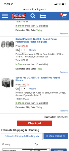

Purchasing parts for my rebuild. Block is 0.030 over. Car show car not a race car. Is going with non file fit rings a good idea?

This was what I’m thinking:
