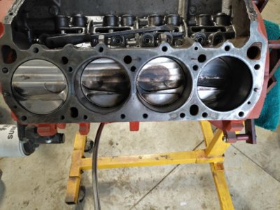

I took the heads off an 440 engine I got with a project car. The pistons are installed backwards! This engine was built by a professional machine shop and was broken in on their dyno. The pistons are KB Hypereutectic quench dome. The was no contact with the valves, probably due to the generous valve reliefs and mild cam. My question is, is it possible that this was done on purpose? They only advantage I can guess is the ability to use a closed chamber head. I have open chamber iron heads so I will be pulling them out and installing them properly, although my quench distance will be over .060"

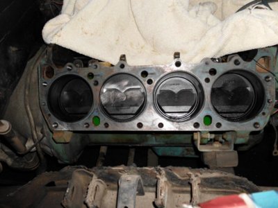

I'm not sure looking at the photo how you determined they were in backwards. Is it from the position of the dome or something else? I believe the dome should be at the base of the piston as installed. At least in my experience they are. Here's a photo of mine for example. Sorry but I must be missing something or the photo has me fooled.
The "dome" is supposed to go into the quench area of the head. The pistons have a centered pin, so there is no advantage to swapping then bank to bank.
The engine was built four years ago, so there is little chance of recourse. I guess someone just screwed up.
I was thinking that they are not backwards as much as they are upside down. If those same pistons were merely moved over to the other bank without rotating them, they would be right. The trouble is, are the rods pressed onto the wrist pins and pistons so the big end taper is to the fillet radius/outside ?

Driver side (odd) leads the pass side (even). The even rods are to the front of each crankpin, and the odd rods are second. Because of this, you can not just swap the pistons/rods side to side, you have to reverse the pistons (rotate) on the rods. If you just switch rods side to side, the bearing will hit the crank radius and lock up.
they're upside down/backwards. used several sets of those type and thy are left and rights plus the dome should be towards the inside of the engine. how dumb can people get. they give instructions with those pistons. end gaps may be screwed up to.
The engine was put together by a chevy guy who assumed that the " dome" had to be in the chamber. Didnt have a clue that it was there to provide quench. Miracle Engine Builders, if it runs it's a Miracle.
I pulled the heads to port them. The engine is now completely torn down. I will be swapping the rods and pistons around. Luckily everything else looks good. I am going to contact the machine shop and let them know what's going on, try to get them to send me a gasket set or something.
