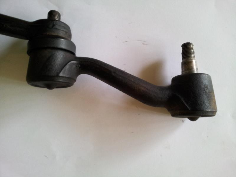

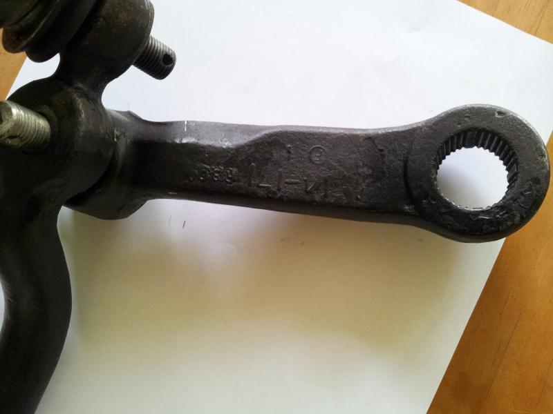

Can anybody identify this Ptiman and Idler arm?
Pitman; about 5 3/8ths from center of cap to hole center. Has 14-171 R860 on it.
Idler; about 5 1/4 between center of caps, has 14-170 on it.
Any help would be great; it was on my Dodge Dart (1962) but the car has had a disc brake conversion so its not oem stuff.

62phoenix, converting your '62 from drum to disc brakes would not require the Pitman or Idler arm to be changed. They look original to me, my Pitman arm from a '62 Dart has casting marks close to yours, 14-806 R708...Nick T.

62phoenix, there are several places to purchase all Mopar suspension parts, but all in the USA to the best of my knowledge like Tex says Rockauto. If you must replace the Pitman Arm remember there are (2) size tapered splines, I'm sure your '62 is the small. You'll start to find the large tapered spine being use more from '64 on.
