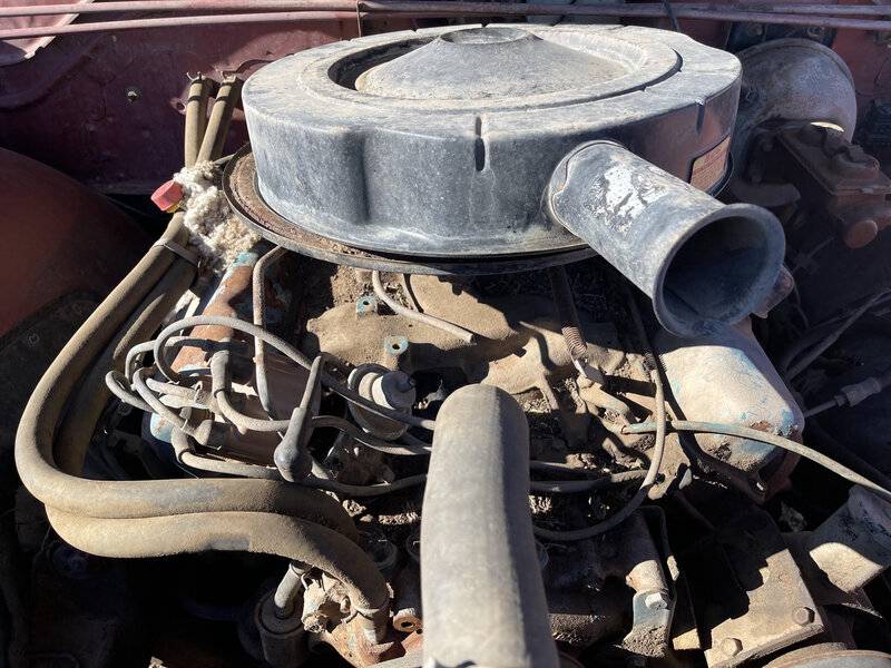

This engine if a couple hour's drive from me, and I only have access to this one photo. It's in a 1967 Newport. I can't see an RB numbers pad on the left (drivers) front of the block, so am I correct this is a 383? Obviously the casting numbers will confirm, but I'd appreciate visual confirmation before making the long drive to pull it. Thanks.

I would think a 383. Judging form the air cleaner it's a 2bbl engine so therefore not a 440. It also seems that there should be a little more space between the valve covers for a 440. The accessories brackets placement is not wide enough for a RB engine. My opinion.

its a newport,its a 383 2bbl.
if it was a chrysler 300,it woulda been a 440.

it has probably 516 heads/Leaded,and a wimpy cam,and a 2bbl intake.
you would want to rectify all that with alum heads/or/later 452-s,a 4bbl intake and new cam lifter,and timing chain set.

I enlarged the photo and it is too grainy to tell. But, as others have said, ask if it is a 2 bbl carb. No 440s ever came with a 2 bbl (OEM).
FWIW, at a glance, I would say it is a 383.

Thanks everyone who helped confirm it's a 383. I'll head over there when I have time off work this week to pull it.

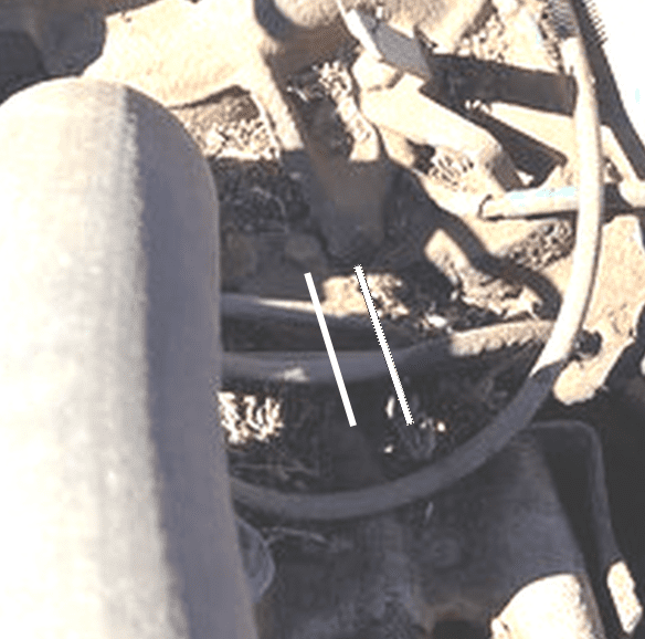

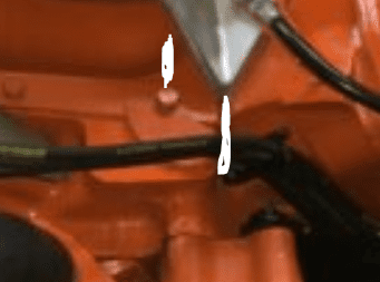

The RB and B valley pan bolt spacing is identical. The RB hold down plate is longer on both ends. You can see the difference here ...........
Also in your picture expanded no pad appears under the plug wire bracket......
