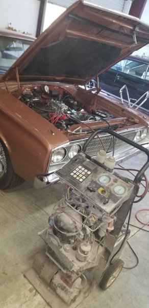

Shop used AC equipment. I found an old 134 machine that has the built-in vacuum pump, on board gauges, and will actually measure and add freon from a 30 lb. tank. I paid $400 for it used and then another $200 for a complete service on it.
Jerry, somebody probably paid $3k plus for that once upon a time. :thumbsup::thumbsup::thumbsup:
Jerry, I think you are on to something here. As I said above, paying $800 and above starts getting cost prohibitive.

It's been years since I did any A/C work for a living. But, if your going to be opening up the system to do repairs, you want an Recovery/Charge System like the one mentioned earlier. You need to capture the freon that's in the system before you crack it open. Also, you'll want tp read up on PAG oil (I think that's the name), you need to add that to the system when you recharge it with freon. The PAG oil is a compressor lubricant, so you don't end up with bits of metal running through the system. I might be out of date on things, but you really have to be careful with these systems.
