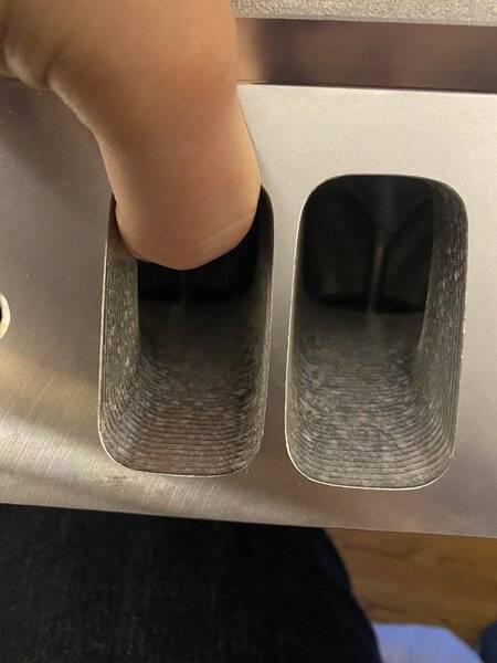

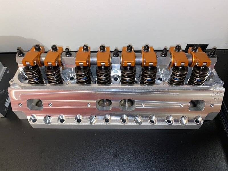

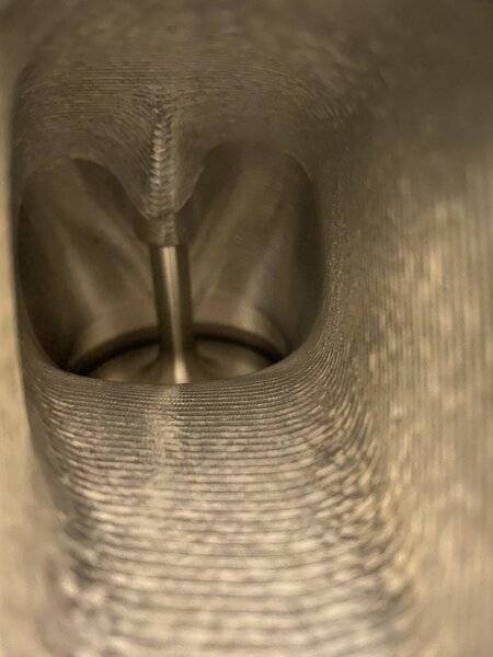

I finally received my TF240 heads after about 5 months of backlog. They are super nice and will be taking them to my machinest/engine builder to run the actual flow numbers and give them a once over. I noticed the ports have a texture to them (not polished smooth) from whatever method they use to make the heads. Should I be polishing inside these ports? I heard a little texture is good to prevent fuel puddling and keep the atomization? Thoughts engine gurus?
I have TF 240s as well on my 440. The consensus seems to be there's no real advantage to cleaning them up that is worth your time + effort - they really are among the best heads you can buy for Mopar big blocks and they are made to bolt on and go.
I say run 'em as is! That's what I did at least
Rough textured ports make MORE power than polished! There are porters working hard at establishing the ideal roughness, and how to achieve it. No state of the art porters are polishing ports anymore.

On the intake ports, the "roughness" of the port surface creates a slight turbulence that helps keep the fuel mixture atomized.

Nice heads!

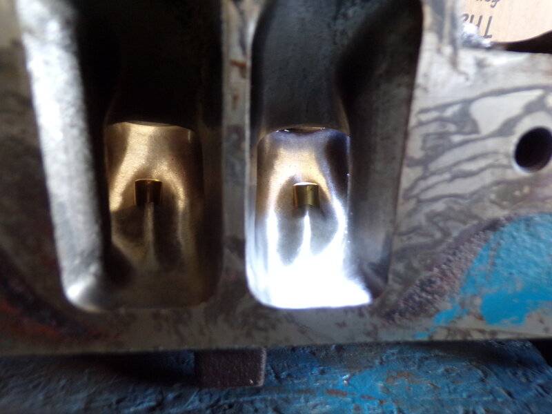

So if we had not polished the ports in these '906' heads we would have made more than 748 HP?
Well that sucks. I guess we're not "state of the art". I'm so ashamed............

Maybe not. There are some very smart guys with record setting equipment who are putting a burr on the exhaust ports and making more power.
Possibly, lol! But i remember you said that you did those heads more than a few years ago.
I sure dont see that quality or quantity of work on iron heads anymore.
I use the very coarse roll on the intakes after the carbide has done its job. The exhausts get the fine roll.
Maybe I'm missing something here.
First, no one has questioned your engine building capability. I have seen many of your engine builds and I am always impressed. I'm not sure how a polished or unpolished port would prove your engine combo would have made more or less power. Obviously it was a well performing engine.
The question and discussion was about the ideal finish on intake and exhaust ports. My understanding is rough on the intake and polished on the exhaust, and I explained why in my post. If the intakes are not rough, then some fuel might go through the engine as a droplet and not be burned cleanly. Quite frankly, I'm not sure that lowers horsepower or not, maybe it just wastes some fuel. I'm not claiming I know.
Perhaps you could enlighten us as with what to do and why rather than just (what I felt) bashing us. I'd love to learn...
