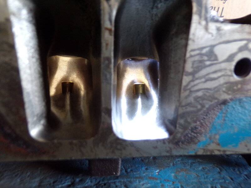

On the intake ports, the "roughness" of the port surface creates a slight turbulence that helps keep the fuel mixture atomized.
So if we had not polished the ports in these '906' heads we would have made more than 748 HP?
Well that sucks. I guess we're not "state of the art". I'm so ashamed............
my engine guy polished the ports smooth on my TFS240's and it made a difference, Turbulence went away completely and the power did go up significately. Like Tom told me have you ever seen a Pro-Stock or superstock with ribs in them??? I didn't think so. The reason it's there is to keep price down, Go ask very successful, experienced engine builders like Dwayne,Jim, Tom @ TK Race, Ray Barton etc... and you will get the same response.My 451 with a flat tappet and making 12" vacuum got easily over 600 on both sides and a fabulous street engine, well behaved and very street able.
We all may be talking apples & grapefruits here. I've never seen a TF 240 head, so I don't know what the finish is. Having said that, a slightly rough finish is common on the intake port to keep the fuel from re-liquifying on the port wall. That roughness may vary. If TF240's have "ridges", that sounds like an unfinished port to be final finished by an experienced porter.
My intake ports would surely look "polished" compared to a rough cast iron head. Just say'in.
Both, but most of the turbulance was on the intake side, The flow bench was bouncing all over the place and after smoothening out it was stable as can beIntake and exhaust ports? or just exhaust polished?
Spot on, I haven't seen too many Nascar teams, Drag teams leaving CNC ribs in the heads or even adding them, Look at the best head guys none have those ribs. They only reason they are there is because it costs more to remove them and in order to keep production costs down they leave them. I've seen back to back test with and without the ribs and there was a sizable gain without, I totally agree with IQ52, Barton, MBE Cylinder heads and the likes by removing them. I'm just stating my opinion and real life experiences that can help out our fellow Mopar enthusiasts.So if we had not polished the ports in these '906' heads we would have made more than 748 HP?
