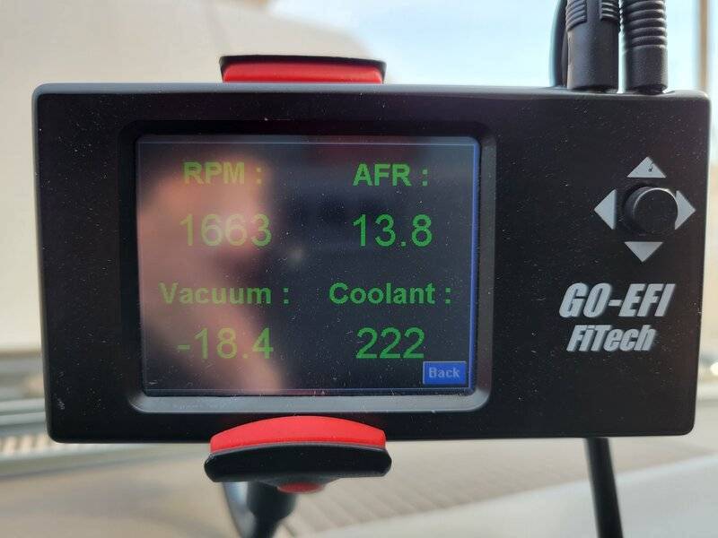

Sitting in traffic, 210 is normal. A 180 t-stat will regulate at 195, a 195 will regulate at 210. Those are what it will typically regulate at while cruising. Mine at 222° after sitting 10 minutes w a/c going in 125° outside temp. Cruises at 176, stop n go at 196. This was after a 50 mile drive and then letting engine idle in parking lot. Heat soak krept up and peaked at 222° then slowly started going back down.

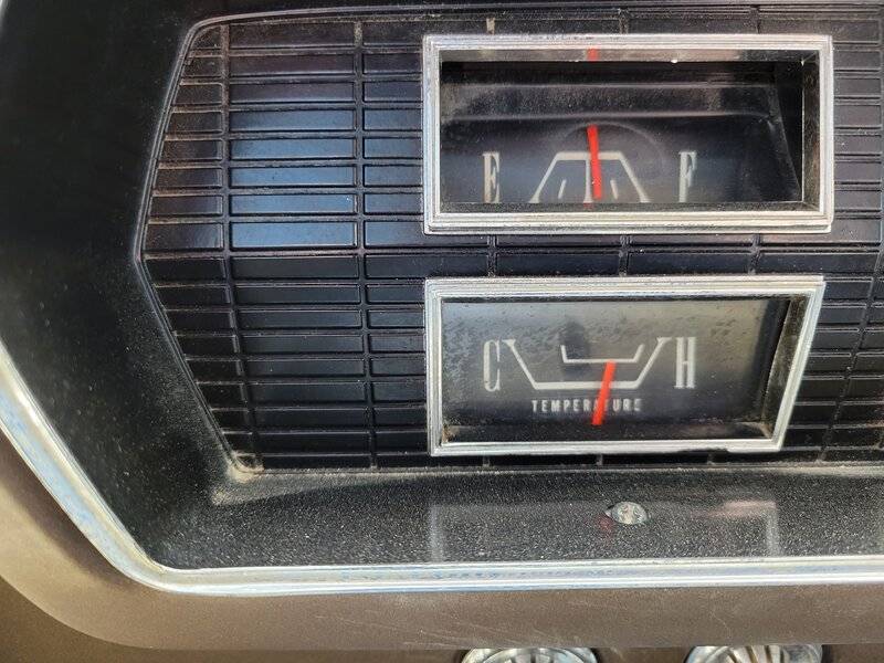

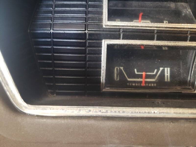

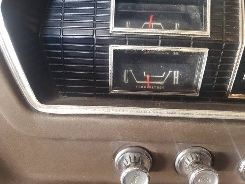

Here's 196° on guage and 174° on gauge. Too many people get a digital or analog guage and see numbers that don't match their t-stat or what someone on a forum or magazine said their car should run at. These are absolutely all normal temps as engineered by Mopar.
