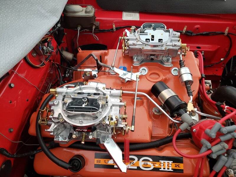

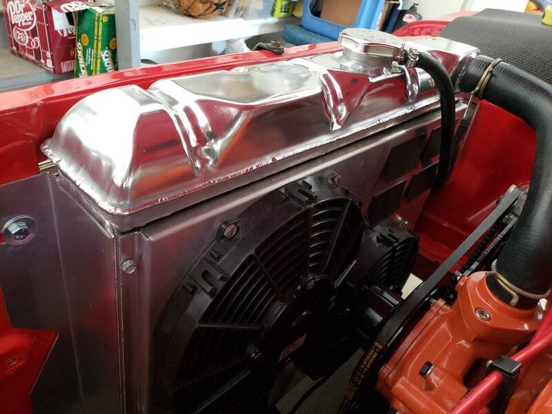

Has anyone swapped out the 22" core support for a 26" core support? If so details..... I can't seem to get my 64 to run under 210°. I've got a Griffin Radiator with the dual electric fans, a 180° thermostat, non hi-flo water pump. Details on the motor....440 .030 over, 11.2 :1, stroker crank 496 cid, full roller motor with a Crane cam. A & A Transmission cross ram intake with a pair of Edelbrock 650 cfm carbs. Set the carbs on a chassis dyno with A/F sensors. 4.10 Dana 60 with a Detroit locker, trans is a push button 727 rebuilt by Rick Allison at A & A Transmission, 3000 rpm stall 10" converter....516hp & 508tq at the tires. Even when cruising the temp won't stay down. It actually stays down longer when sitting still idling. On a mid 40° day the temp stayed down under 200° but as the outside temp goes up it runs hot. I've had other Mopars and never had this problem

I fought a cooling problem for about 6 months in my 496 w 26" aluminum radiator. But mine was at highway speeds. Aluminum shrouds actually created a high pressure zone and air would not get through the radiator. Went to mechanical fan and factory shroud and all is good. In the cooler weather, below 80°, I can't get the engine to 170° with a 180° t-stat. I use a Mr Gasket 180, flowcooler water pump and add 2 bottles of that pink radiator additive. In 100°+ days, it cruises down the interstate at 186 n in town at 195. Wish you luck.
Thanks for your reply.... I wondered about whether the alum shroud/elec fans were causing an air flow problem. Now I have to try and find a shroud that will fit my Griffin Radiator. Then will put together a clutch fan set up

Are both your radiator hose connections on the passenger side? If so, you may only be cooling with a small portion of the radiator without enough cross flow.

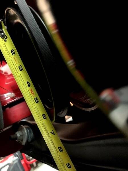

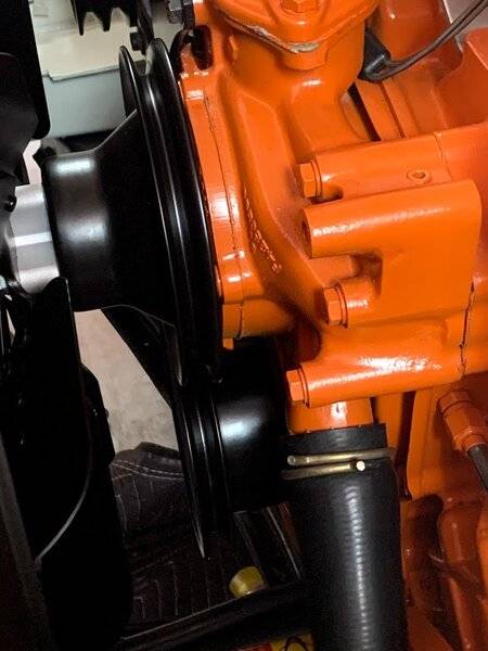

Change your lower pulley so it is bigger than your upper pulley and get a bigger belt. I’m running 650 to 700 horse on stock radiators and fans. It’s all in the pulleys. Your under-driving your water pump. It’s all in the pulleys.
What is the size / measurement of your upper and lower pulleys ? Thanks

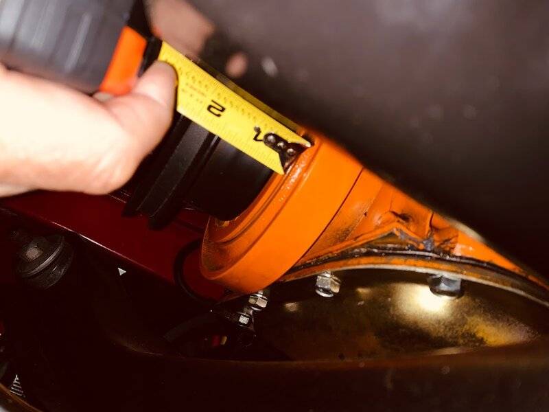

I'll be working on the vehicles today and I'll get you those measurements. I had the same problem where someone put an aluminum lower pulley on to "gain horspower", LOL. Wouldn't stay cool pulley was way to small Same thing on my Hemi's the Race Hemi crank pulley was to small for street cruising, stop and go, etc. changed to larger Max Wedge Pulley and Bingo Bango all four of my rides never over 185 no matter the weather, etc. And I live in Mississippi with 95 degree 100% humidity days and stop and go traffic during cruising the coast. Here is a couple of old photos. Ill get you better measurements today.
View attachment 1102295 View attachment 1102302 View attachment 1102303 View attachment 1102304
Sorry for late update, don't know where my minds was. All 4 of my cars (2 Hemi, 2 Wedge) run the same combination of Max Wedge/Race Hemi Water Pump Pulley and Max Wedge Crank Pulley. All four run 180/185 tops. The smaller race hemi pulley ran about 230 and I would end up bringing it home and it was stumping me. Read a great article on pulley size and overheating, swapped the lower crank pulley and voila! Awesome feeling when it worked! LOl! Hope this helps!
Doesn't appear to be
