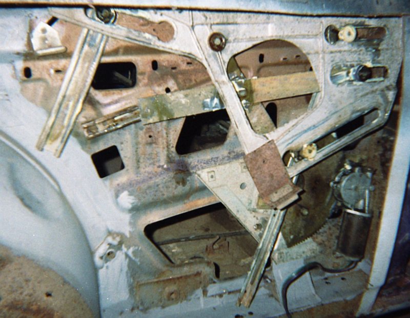

I am up for the challenge as long as I had good pictures of the inside of the rear panel, Maybe from this site someone had pictures with a quarter cut off.

Wish I took more pictures, this is all I could find from mine.
That's a good start, Thanks for the photo. I will have the post car in the shop shortly to replace the motor and trans. I will take a closer look to see where it needs to be cut.
Note that even though I have a power window in that picture, the car originally had regular manual wind-up ones and the mounts were the same.
