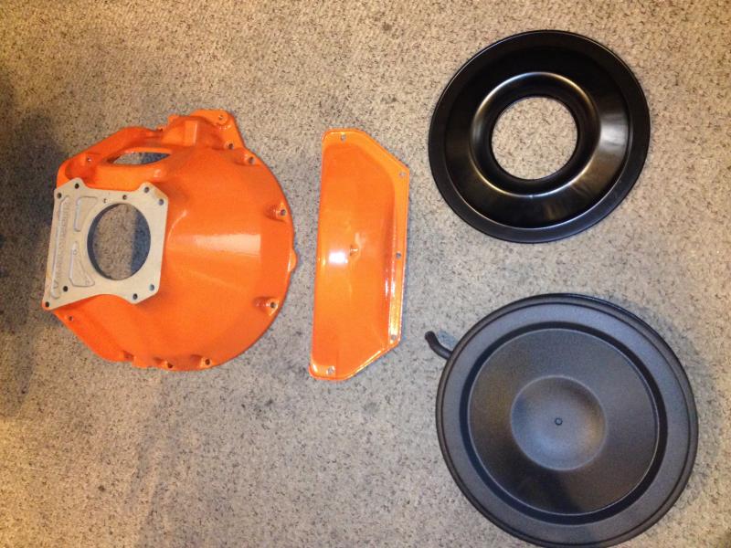

Here is some of my parts slowly being powder
coated. Bell housing, air filter lid and base.
I have parts and pieces scattered everywhere and have not recieved the invoice for any of the powder coat yet, I have been getting invoiced once a month from a lot of the out sourced companys. I hate to say I dont have a price per piece but have been paying a lot of hourly for some of the repairs. If my dog was ill I would say just make him bettere I dont care about the cost. I went way over budget any way on the first day I purchsased the Charger so why stop now. She will be nice and i will drive her alot this summer. I will try to get some pricing for you. There is a lot of people local that do powder coating now a days.

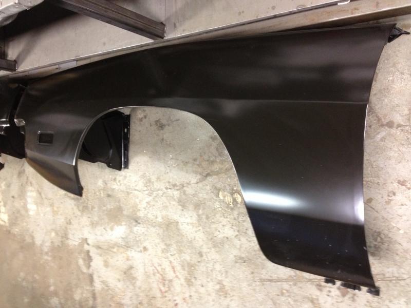

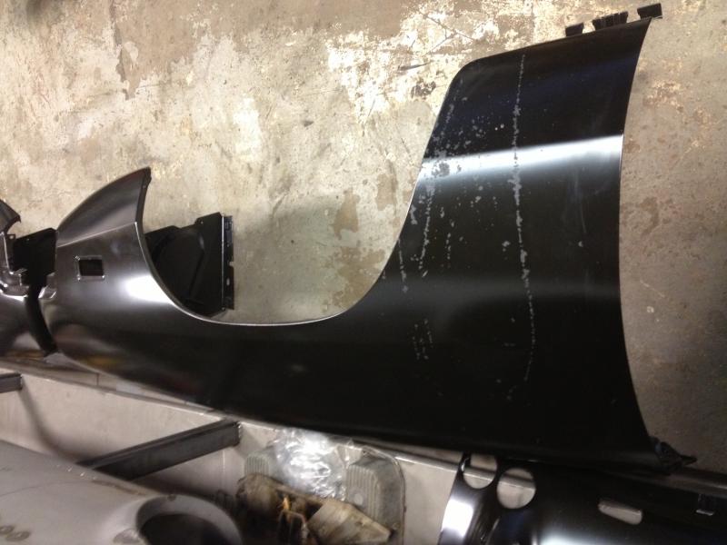

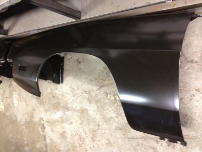

Just got both front fenders back from stripping and ecoating
