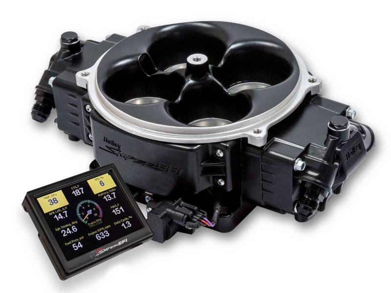

I’m excited to try out the Holley 4500 sniper, getting one for the new 505.

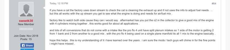

Hey Dennis,
I'm interested in this EFI technology Edelbrock has to offer, Pro Flo 4 to be exact. I was wondering if your install was a single O-2 sensor or dual? I would think you would want to monitor both banks for accurate AFR or am I tripping?

Hey Dennis,
Solo. Checked with tech. Thanks for clarifying.

Okay, so the computer only sees the data from one bank and applies the AFR to the other without knowing what the actual ratio is.... hummm

Always looking to dial in. This on the to do list. Do modern cars have 2?

Yes and my grand marquise also.
This is to determine catalytic converter efficiency, not really performance.
Yup when I changed the cats to high flow units from dynatech I was getting efficiency codes for the cats. Had to get a custom tune to get them to go away.
Response from Edelbrock Rep on 0-2 sensor question.
