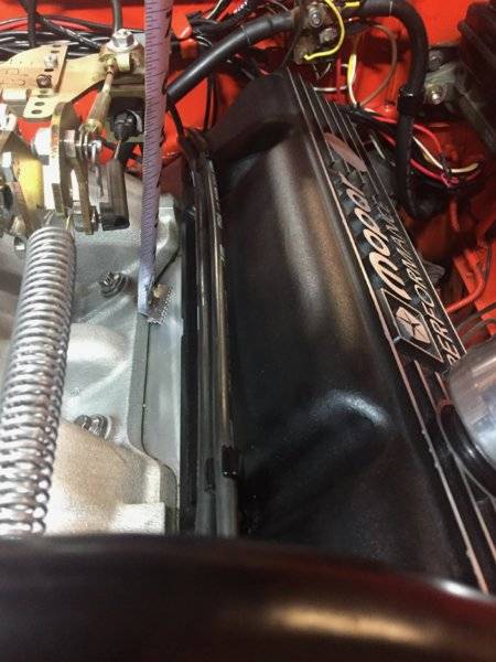

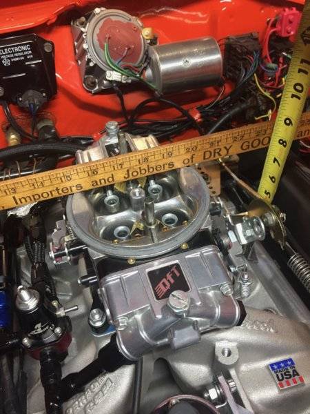

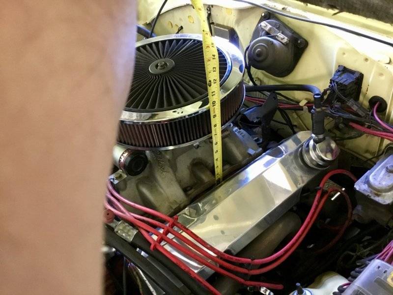

Rough measurements, but looks ok by about an inch. That is a drop down dime store air cleaner. View attachment 646345 View attachment 646344
Hey Dennis would you mind attaching a photo like the one I've got below for comparison? It's obviously a photo with the air cleaner removed, with the tape measure resting on the "joint" between the intake manifold and the head (second photo), similar to the photo you took, but without the air cleaner. I am running the same air cleaner, but with the hidden dropped-base (mine or yours), it's hard to compare my existing combo height to yours... My setup: 1970 Roadrunner, 440 RB Block, Edelbrock Performer RPM intake manifold (#7193), QuickFuel carb = looks like it's about 7.5" high to the air cleaner base at the top of the carb.

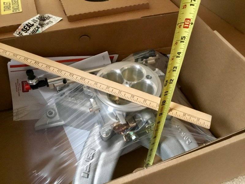

With the same air cleaner you're running, the top of the air cleaner already touches the hood insulation with my current setup. For the Pro Flo 4 model 35910, the Edelbrock website says:
  • Manifold Height: 6.100 in.
  • Throttle Body Height: 2.250 in.
That's 8.35" compared to my 7.5". I'm not sure I can manage any additional height. The Roadrunner hood may be different than the Dodge hood (??? Anyone know if they're the same height?) It looks like the Coronet/Bee '68 Power Bulge may be taller than the '70 RR...
