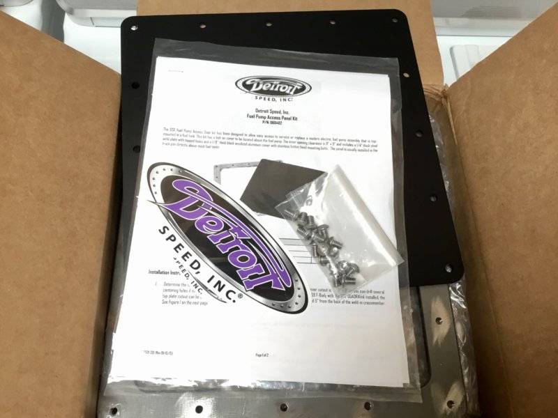

Doggy door for the trunk floor arrived. Detroit Speed. Thought it was hinged, it is not. Still better than dropping the tank.

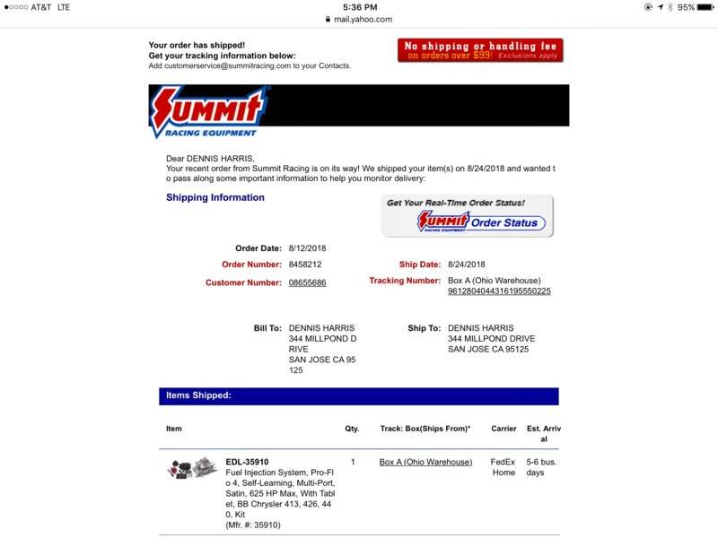

It shipped! Under promised, over deliver. This is why these businesses drive the American Economy. Some do get it.
