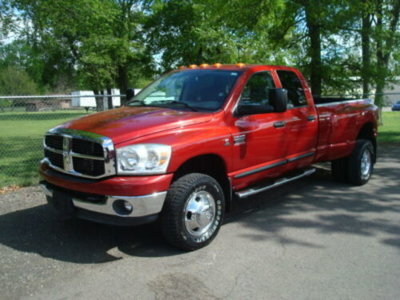

I considered. But they too are rated lower than what would be asked. I even considered 6 speed manual NV5600 that is currently in my 2007 Cummins Ram 3500. But it too is only rated to about half what is needed. The Alison would require some bellhousing re-design.
