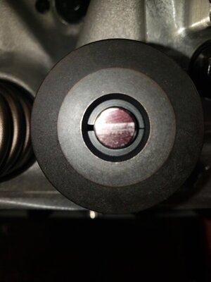

The kit comes with shims in 3 different thicknesses that you use to position things. Its a pain because you have to keep taking the whole rocker shaft assembly apart to add or remove shims but seems to get the job done. When I say centered I mean the roller side to side over the valve tip.
Thank you! I have to do this on a 440 HP build I'm doing. Did you fill out the sheet from B3 to get the proper shims? Could you post a photo of the shims please. 440'
I did not do anything with B3. The shims I'm speaking of came with the rockers and slide over the shaft to move things side to side. You are thinking about the kits that change how they ride on the valve tip front to back mine were fine.
Okay, I understand. Great pattern on those stems. Looks like you're geometry is properly set! 440'
