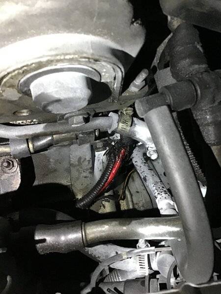

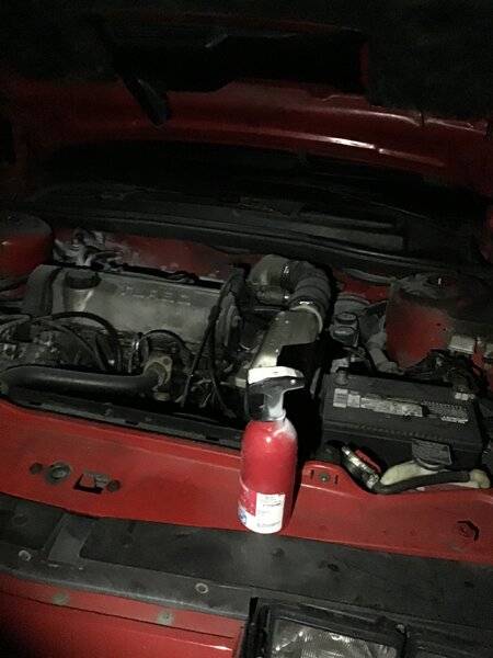

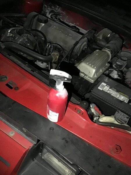

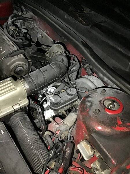

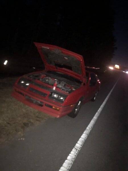

Was going out for a late night drive. slowly started to smell something burning that I can tell wasn’t coolant, oil, fluid etc. The dreaded smell of copper wire and insulation....
Pulled over and the cabin started rushing with smoke. Smoke and flames in the engine bay. Quickly pulled off the ground cable and grabbed the extinguisher.
The starter wire rubbed through and shorted to the block. I was parked directly over dry brittle grass as well. If I didn’t have my extinguisher I think I very may well of lost the car tonight.
Please if you don’t carry an extinguisher in your car, go to Home Depot or Lowe’s, you can get a pack of 2 for 50 bucks. We aren’t driving 2020 Cadillacs or Camrys; especially those of us that Daily drive these 40-50 year old car. It’s almost a guarantee something will go wrong eventually..

have one of the Halen extinguishers in my satellite. Boy they’re expensive but promise they’re worth it. A dry extinguisher may save your engine bay, but you better pray it doesn’t all go down the intake... especially if it’s a high dollar build
Dry chemical?
A dry chemical one I had laying around awhile ago. Thought it’d be better than nothing. Was worried it’d be too small!
