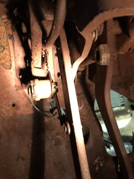

Down to one nut that is connected to the master cylinder. It is not going to come out with the tools I have. I have put penetrating oil on it for 24 hours, heated it up and still, it would not spin without my socket giving way. Then I banged the socket it on with a hammer, to make it seat all the way, and still nothing. The angle in which I am working is a contributing factor.
Here is my question, what if I grinded the stud from the other side--the mounting stud for the master cylinder. If there are threads, I am not sure it would help; however, I believe I remember master cylinder mounts to be flat. Another thing I noticed was that I could not drive out the other studs easily.

Here is a pic. It is toward the top in the shadow.

Six point deep socket and a universal joint with electrical tape around it to keep it from flopping around and a 12" extension .
It is rusted bad. There was no frame under the floorboard. I am not saying it was bad, I am saying it was gone--completely gone.
It is now stripped. I was getting well seated on the nut. It was just the angle. I was not expecting to be able to put that much force and still strip it out that slowly.
I am on plan b, and I expecting to be going through the alphabet on this bucket of fun.
Woo hoo!!! The pedals are out. I wish I would have started with plan b. I grinded off the top of the master cylinder stud, and that took 5 minutes. Then I tapped the bolt out in about 10 seconds. I wish I would have done this with all six. LOL!!!
