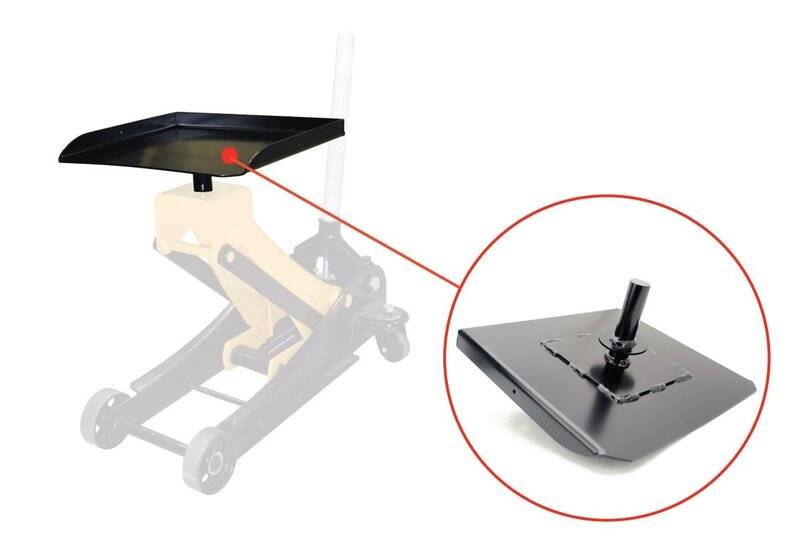

I have an adapter for a floor jack:
?u=https%3A%2F%2Fwww.speednik.com%2Fwp-content%2Fblogs.dir%2F1%2Ffiles%2Fimp%2FTCI-Floor-Jack.jpg
but my current jack is a piece of Chinese junk. I need to get myself a good one.

Yeah, I've used a floor jack before. Problem with those is they are very linear in their movements,
whereas the trans jack's wheels swivel in all directions.
Minor point.
I made mine out of a piece of 2x8 wood I had laying around and some casters from an old creeper I had laying around. It worked perfectly and didn't cost me a dime. Best part about it was i could roll the trans exactly where I needed it and then slide my floor jack under and lift the whole assembly into place.

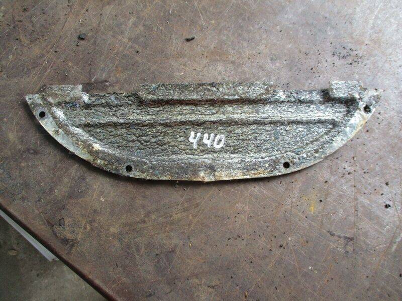

I'm going to add a question to this thread because it seemed like a relevant thread to ask my question: I've decided to remove my 400 engine from the top without the auto trans. I have hoisted the motor and slid it about 1/2 inch from the transmission but now it seems to catch. Before I start working at it in earnest, is there anything I need to worry about in separating the motor from the transmission? (I've done manual transmissions before but never an automatic.) Thanks! Terry
If there is something catching then something is still connected. Can't tell you what's catching but Look all around the engine under,over,behind and in front. We can't see your engine its up to your eyes.. THe one thing I can think of though is did you take out the torque converter bolts? The torque convert bolts directly to the flex plate. That could be a snag point. Did you remove the lower inspection plate on the transmission? Those are items I would suspect since you dont mess with automatics much. Inspection plate shown below. You will have to remove this to get to the torque converter bolts.
