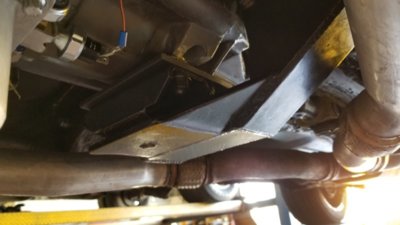

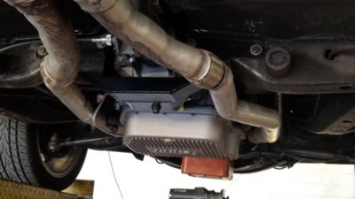

The drive line angle is the most important thing and you have to cut quite a bit to get it right here is what i had to do to my wife's 71 ssp with 92 magnum and 518 I had to raise the tunnel by 1 1/2 inches and widen on both sides drivers side more cut out the center of the torsion bar crossmember and replace it with 3/4 inch x2 inch flat stock with the bottom of it on top of the original tunnel height you can use the original tranny mount crossmember with modifications lots of work by it runs great and no vibration
Thanks man! I'll show these pictures to my dad. Clearly, we should've done it last summer before the under-body was painted and the inside coated. I was hoping for a cleaner drop in.
I just noticed your trans mount cross member mounts the transmission a good 2-3" inches higher than the one in the Hot Rod's article. I wonder if a fully custom trans mount would lower the trans enough to clear the floor. Of course, then I would need to shim the rear to make sure the pinon and driveshaft angles are correct. Something to research more.
View attachment 497184 View attachment 497183 View attachment 497182 View attachment 497181 View attachment 497180 View attachment 497179 View attachment 497178 View attachment 497177 The drive line angle is the most important thing and you have to cut quite a bit to get it right here is what i had to do to my wife's 71 ssp with 92 magnum and 518 I had to raise the tunnel by 1 1/2 inches and widen on both sides drivers side more cut out the center of the torsion bar crossmember and replace it with 3/4 inch x2 inch flat stock with the bottom of it on top of the original tunnel height you can use the original tranny mount crossmember with modifications lots of work by it runs great and no vibration

Yes. I went with the JW Ultra-Bell setup. And we welded a half in stock (see pictures above), after cutting out the crossmember. See the link in my previous post since they now make the crossmember (I had mine custom built and powder-coated - but it did not exist last year when I started my project).
