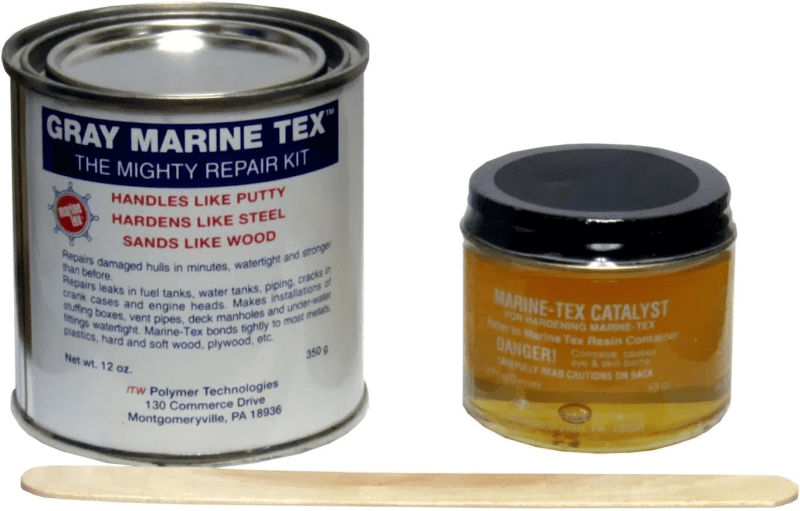

I get rid of the swiss cheese flange, make my own, and weld it solid...... I use marine-tex grey as a base filler, I have no issues with all metal

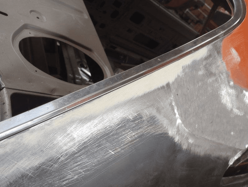

I like lead. I worked at a radiator shop and it’s really not that hard. Obtaining flux that actually works, that is kind of a pain in the ***. I’ve used tinning flux in the jar, but liquid works so much better. Heat, hit with flux, tin the bare metal. Heat the area and apply solder. Use the liquid flux to control the solder and keep it from running. I use a wooden handle I shaved down as a “masher/smoother/spreader” too much heat and it will end up on your feet. Smaller flame is more controlled but heat concentrated to a little area. It’s easiest on a rotisserie, where your work area can be horizontal. I’ll look for pix shortly

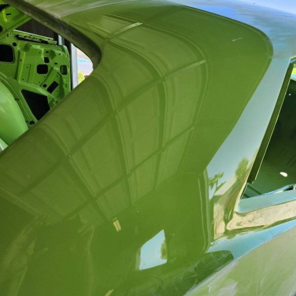

I've had more than one car with rust under factory lead. After cleaning to bare steel we epoxy prime, then Duraglass. Final top coat with a very thin layer of filler as Duraglass is quite coarse. If it's a racecar we weld the seam solid first. My Challerger, Road Runner and Belvedere race car were all done this way. Road Runner was painted in 1986, Challenger 2003, Belvedere 2012. All seams still look perfect. All 3 are show quality paint.
