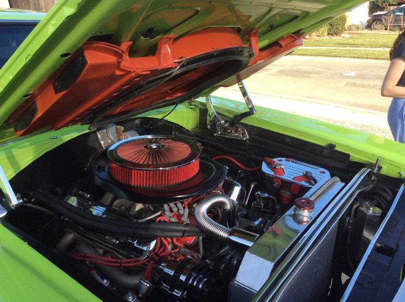

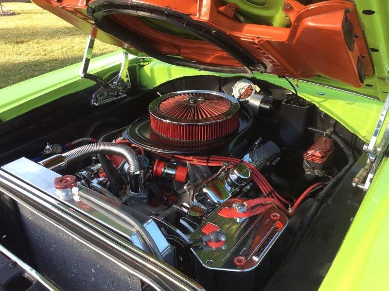

Hi Mikey Yes the round filter KN
I did mine like this. Sealed up fine. That’s a 68 Coronet with a 400 and an edlebrock rpm performer. 3 inch filter.
Ah hah!! The picture is worth 1000 words, right? Thanks guys. That’s perfect. That is exactly what I was looking to do. Something like that.
Also, it’s great to know that a performer RPM intake will work with the ram charger intake, even if a different filter/top has to be used. I am good with that as long as I get colder.
