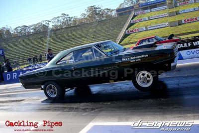

Finally had a day at the track to try the new TF270 heads
It was 1/8 competition with some 1/4 testing
I had a couple of issues so ran 4 1/8 and 1 1/4 passes
I reweighed the car 3690 lbs on startline
These heads definately deliver
1/8
6.587 6.554 6.583 6.539
105.54 105.30 105.17 105.68
Nearly 1 1/2 tenths and 2 mph gain

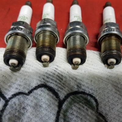

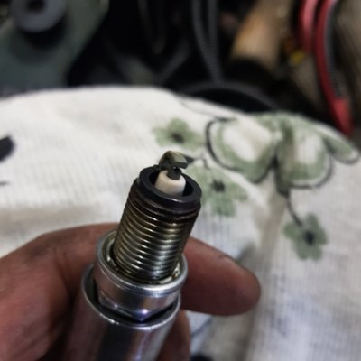

Right hand bank plugs , left bank are same .
Pulled them tonight , havent started it since i got home saturday afternoon
Single plug is #3

yeah I am working through things . The motor seemed ok after the run home moisture wise so maybe ok . Going over the day it is my fault the breather blew out , wrapped catch can in a rag , Now having cover fittings welded not pushin . Also catch can drain was crap and may not have fully drained
