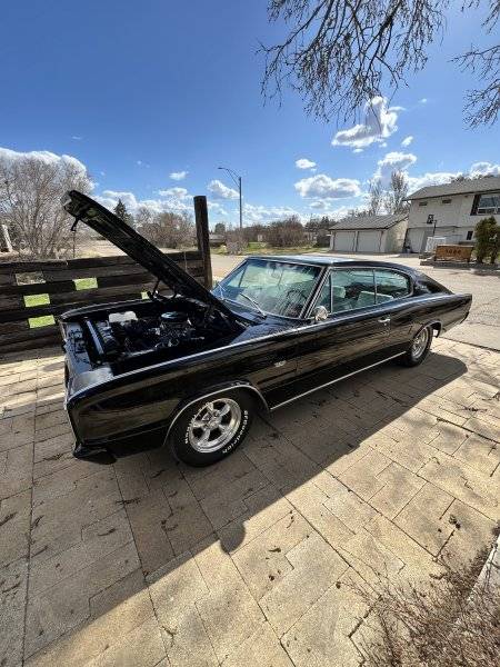

So I am having trouble diagnosing a sound my car is making while accelerating, it’s a metal rattling sound that happens when there’s more vibration from pushing on the gas.. 1st thought was loose exhaust clamp or heat shield but everything seems tight.. Speedo makes some noise but that’s a different sound. This noise is louder and comes and goes, usually after driven for a while. Any help appreciated. Can’t attach a video..

No it does not make the noise in neutral while reving it, only it hear when moving, but not constant. It’s an automatic 727, 383 engine.
