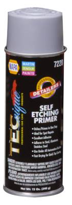

if you must.....go to napa..... get a can of etch primer and put 2 very light coats on them, like a film.......... scratch it up/off later with 120 grit or so, and epoxy it
I have always been told that etch and epoxy primer cannot touch each other. Maybe that doesn't apply to rattle can etch? My thinking is by the time he goes through the hassle of removing all the etch, do it right the first time with epoxy.
I stand corrected..... as per the SPI tech sheet
I always assumed it meant a "wet on wet" application
I thought it could be sprayed over "any sound subtrate"....... my bad

Self etch primers are a primer, that has some acid in it to help adhere to smooth metal. Self etch primers really should not be used on sand blasted metal, for the same reason.
I'm not really a fan of etch primers. Filler cannot be safely applied over top because of the acid in the etch primer. Etch primer has it's place, but it's more geared for sealing bare metal that doesn't need any repair.
