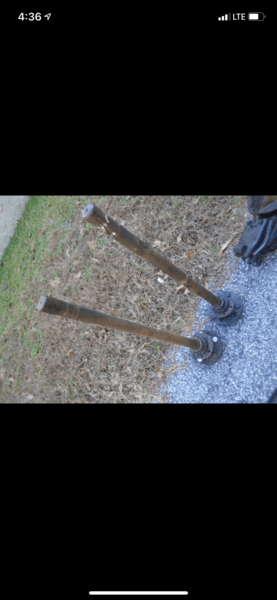

I bought a 8 3/4 rear and axles, history unknown. The bearings appear to be ok and I want to repack them and try them out before replacing. Should I:

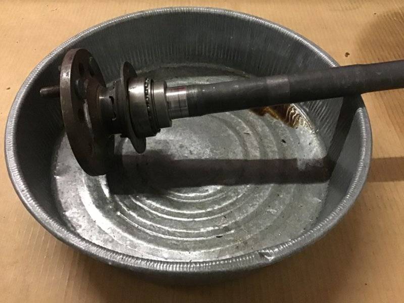

Look at this picture, I know it’s a highly technical operation, it’s call a drain pan and a parts cleaning brush. Pour some solvent, scrub the parts. Roll the bearings, rinse with solvent, about 5 minutes on each one. Maybe new technology to some, but it’s just like washing dishes, have you ever done that?

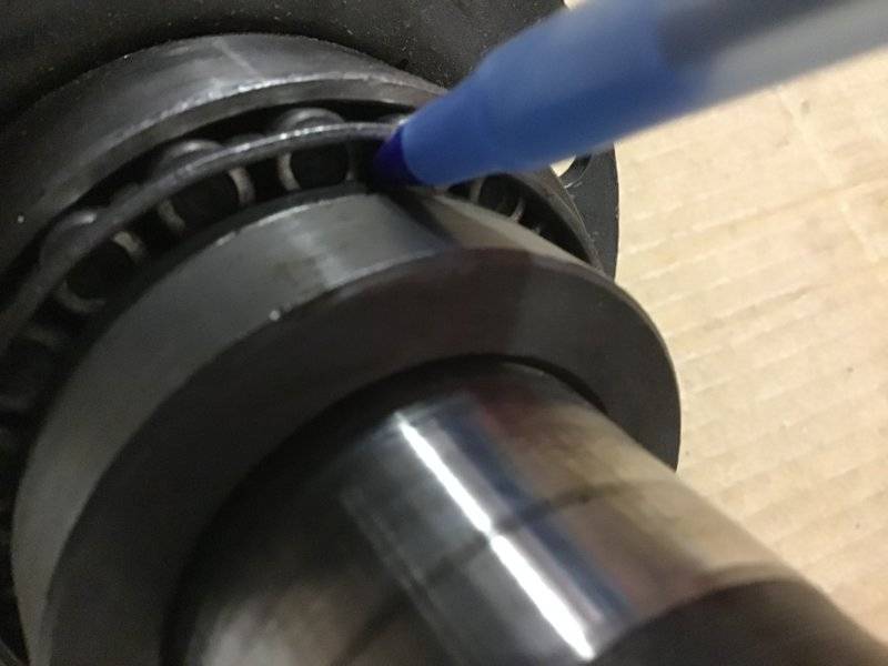

They need to be CLEAN when you are done, no grease or grunge left in there. And fill te area where the pen is with grease, not above that, it will get grease there by greasing this inner area I’m pointing to.
