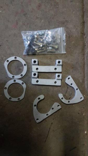

I snagged a kit up in Summits scratch and dent department a while back and am finally thinking about installing it but have a question. I really dislike the idea of downgrading from a tapered bearing to the green bearing so is there really a reason why you have too? Obviously the main reason I believe they do this is to clean up the axle flanges to allow room for bolting the new brackets whereas I'll weld mine on? My only question is what about the side play, if memory serves me correctly the 8.75 is set up with .007 end play in the axles where a green bearing would be more positively located, .007 is peanuts and under load likely doesn't move at all?
Just looking for insight, talked to Right Stuff and really didn't get an answer other than "follow the directions".

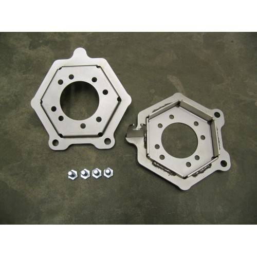

Check out these brackets. It says no need to shim the tapered bearings.
With these brackets you can easily and very economically convert your existing drum rear to disc brake with our AutoCAD engineered brackets. We make these brackets right here in the USA with state-of-the-art CNC laser machinery for excellent fit and finish. The inner section is made from 11 gauge steel, the same as you existing drum backing plate, so tapered bearings will not need to be shimmed.
This setup uses Toyota Previa rotors and T-Bird rear calipers, giving you an excellent affordable system. It matches your car's hydraulics very well, and it will fit inside Mopar drum 14" and up rims.
Note you will need to machine the axle flange to fit inside the rotor and that the rotor may need the pilot hole opened up.

That article covers my previous question, the shim they speak of is to compensate for the drum backing plate which their bracket replaces keeping spacing the same. Nice to see the kit they like uses the same calipers that are in my kit.
Guess I should have checked the latest offerings before posting, this article answers my question. I didn't realize in the short span of time since I've looked at them that companies are already offering brackets that retain the original bearing... Sweeeeet!
