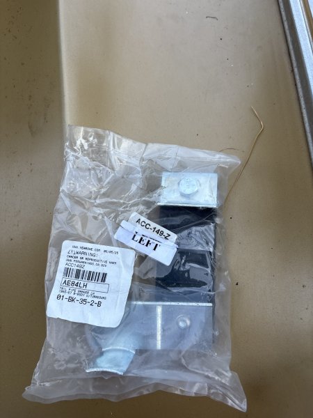

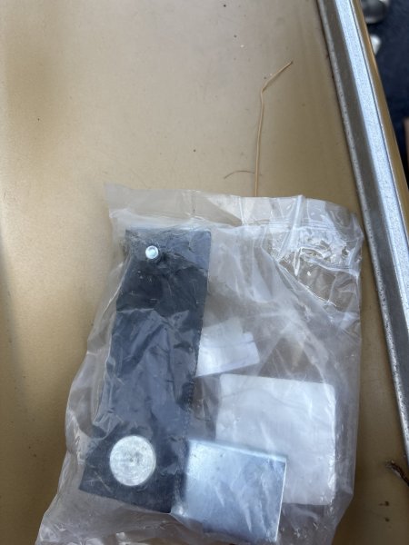

I bought a pair of rear exhaust hangers from year one, but where the hell do they mount to? The have a nut that inside a hole, but where?

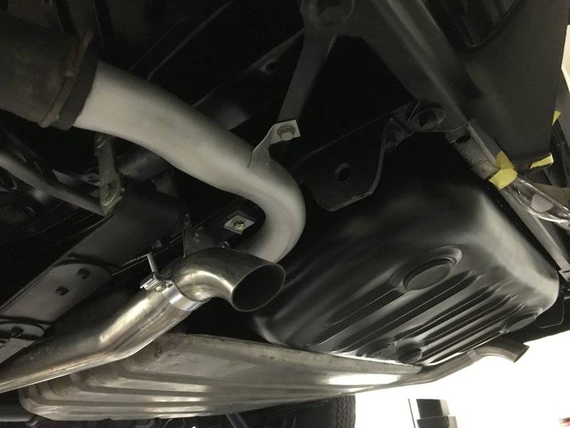

They bolt to the bottom of the frame rail. Can’t recall if there is a weld nut or access to place a nut inside. Mine are home made but roughly mimic those in your post. When installed there will be a 90 degree bend in the rubber. This will bump you back up where someone may have a better memory.
The brackets I bought have the slips nuts with them, now I just have to find those holes, they are on the bottom of the frame rails? Thanks.

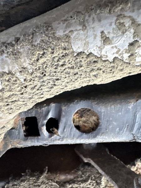

Pretty sure it's just like post #2. Should be a square hole beside a round hole, and the slip nut goes through the square.
67 charger..

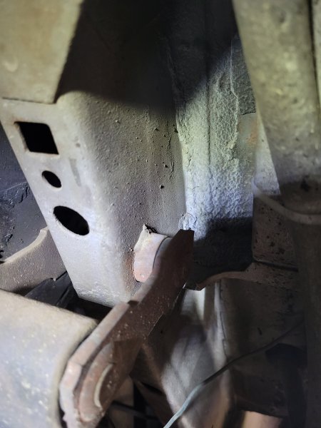

Bottom of the rail or side? I guess the hanger could work either way.
Are you able to see the pic in post #2
I was viewing it on my home computer. I just checked it out with my phone. Now I can enlarge it. Now I get how it goes. I can’t see any holes without removing some of the thick undercoating, but hopefully they are there.
Well the right side should be visible at least , all cars had that one in use. Unless it was removed and undercoated over later.
Both the passenger and driver side have the holes I need.
Yes they were all made with the holes, but only dual exhaust cars used the left side.
So your findings are exactly what is to be expected
