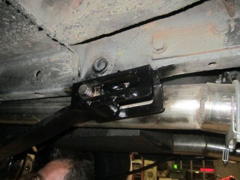

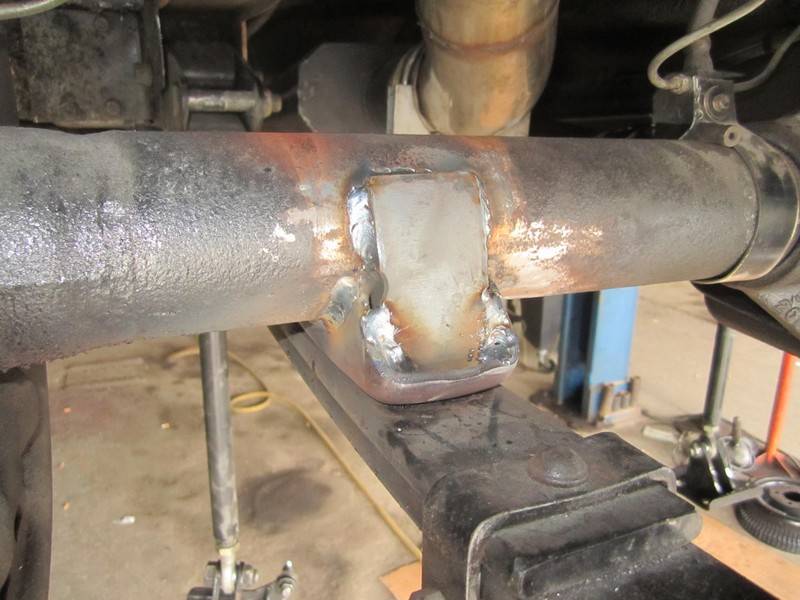

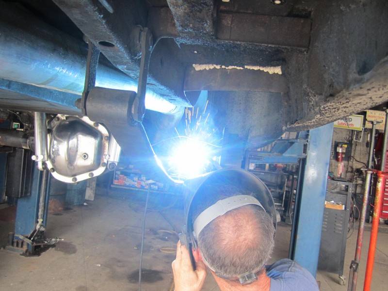

1st install I put it in the middle,but on extension the roller bearing hit the front of the slot.Had to Unweld it and move it forward.Question, on your sliders how much space do you leave for the spring to move forward. One inch or half inch. Or do you just split it down the middle. Next question length of shock should it be longer or is there a standard shock to use.
