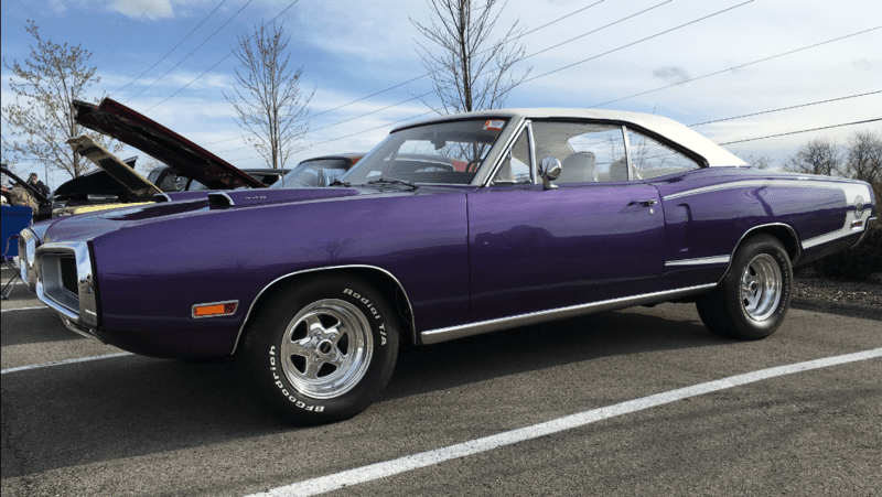

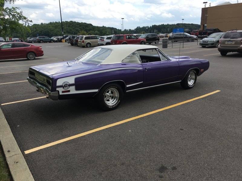

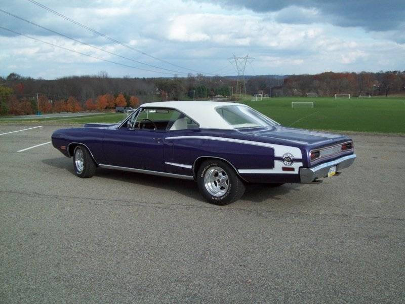

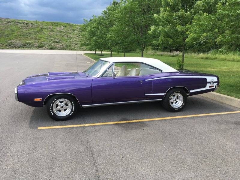

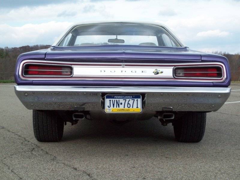

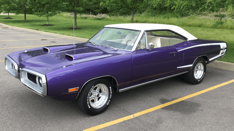

I used there hd springs +2”. When I first put them I thought I had made a mistake. But after a couple days of driving they settled in nicely. Wouldn’t change a thing.

Can you please post a pic of them on the car and settled
I also raised the front a bit. I prefer a car that sits a little higher all the way around.
Some prefer a lower stance, that’s up to you.

View attachment 785234 View attachment 785235
Wow that is an amazing looking car!!! Love the purple and white combo. I plan to do heavier torsion bar in the front and sit a little higher too. I like that look for the old B bodies
