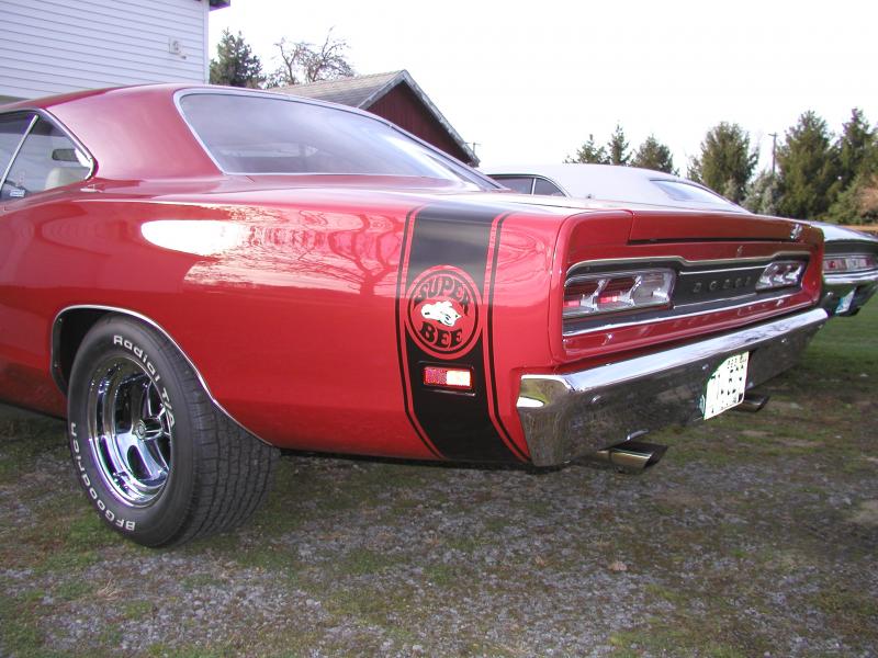

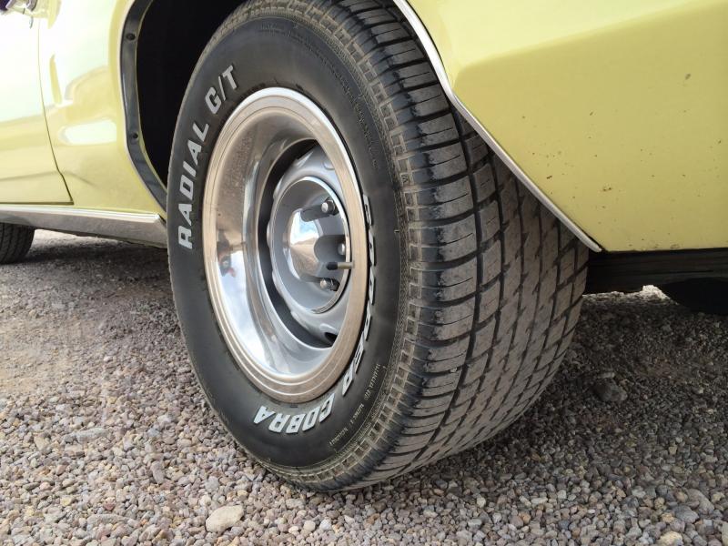

What's the largest rear tire I can fit with no modifications on a 15X8 rear rim on my 69 Super Bee? I am running 275/60/15 now, but I have seen pics of cars with the tire filling up the well better.
295 50 will give you wider tread but will be shorter IMHO
image.jpg 295 50 15. 8 inch rim.
Can you post a bigger pic?? I see the one in your signature, but cant make it bigger
No, the big wheels/tires aren't in my photo gallery. But I put up pictures in the numerous other posts about what wheels/tires to run. Will put more up tonight.

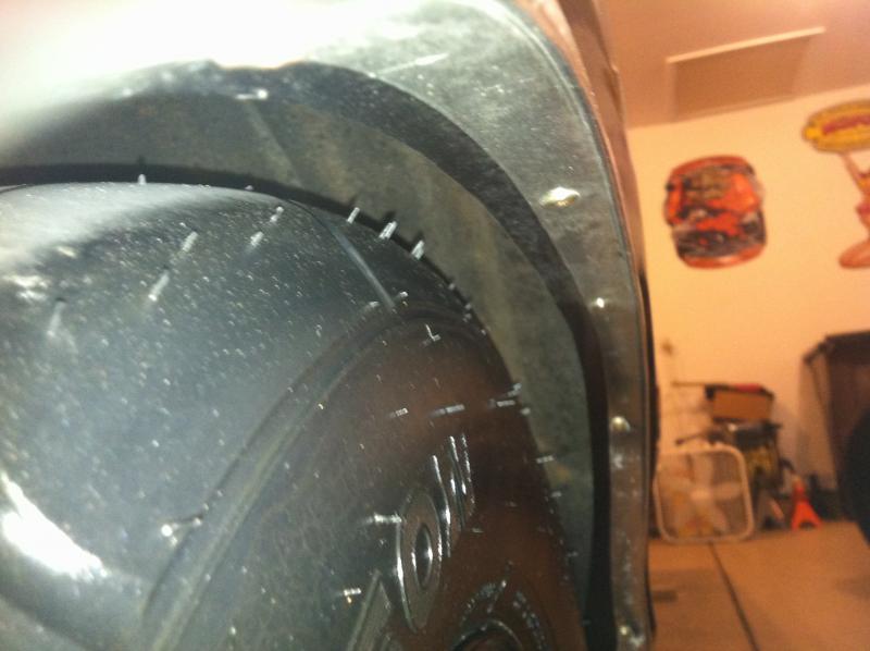

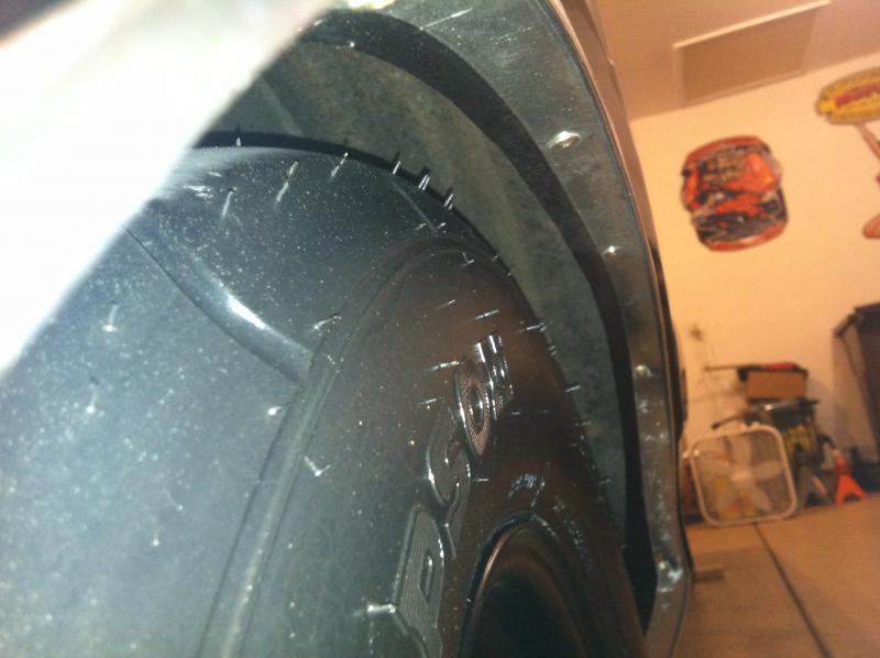

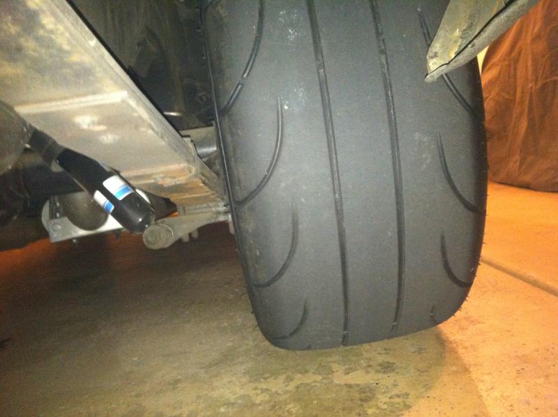

Here pictures of the 295/50-15 tires on a 10" wide wheel with 5.5" backspacing.
Thanks for you help....that looks great......now I need to buy 2 new rims and tires!!
