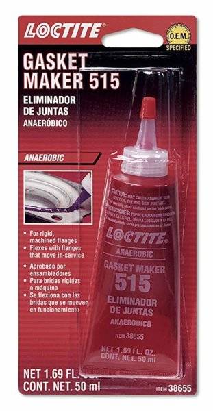

Guy, what do you use on intake pan gasket?
Try LOCTITE 515.
