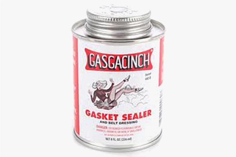

This is THE best stuff I have ever used. It is NOT cheap.

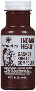

I use Permatex Aviation Form a Gasket, and #2 quite a bit. I think the #2 is about the same as the old Indian Head stuff that a lot of guys liked.
I think I started using this around 1972 or so. Ask me how many leaks I've had on customers, or my cars.... the answer resembles the letter OH.

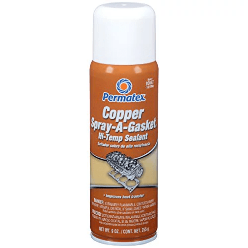

Permatex High Tack gasket sealer and Copper Spray-A-Gasket more often than anything else. Still use a little Ultra Grey in some locations and a light application of red RTV on exhaust manifold surfaces. Permatex #2 for thread sealer where oil is involved. Trying to stay away from the abuse of RTV by slathering it all over everything. I’ve learned to value the ability to disassemble parts and not spend hours on cleanup. For that reason, although I have a couple tubes of the Right Stuff, I won’t use it on anything there is even a remote chance I may need to ever take apart again.

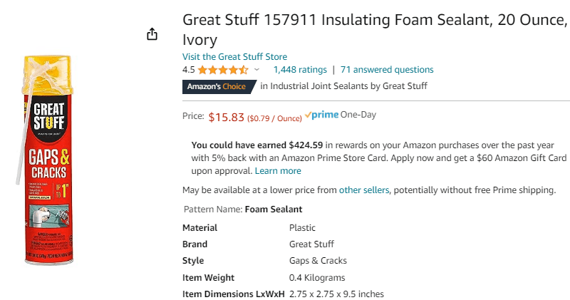

Loctite 518 for everything except oil pan gaskets. Great Stuff for oil pan gaskets.
