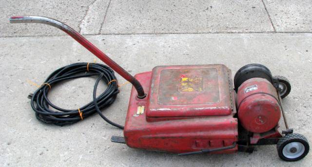

Is that they type that spins them on the car? We had a machine with two big electric motors that spun them on the car(Front) and it would do a great job, it spun them at well over a hundred miles an hour.
No, You are referring to Hunter's "Tune In' on car balancer from the 50's/60's. The Road Force machine looks like a standard balancer but with a computer screen and large roller that applies force to the tire as it spins mimicking the real world situation of the tire on the car going down the road. It measures the amount of "road force" in the tire. Passenger car tires should ideally have no more than 26lbs of road force. The first step using the machine is too measure the rim run out. If the rim run out is acceptable you can proceed with measuring road force.
This is a Hunter Tune In on car balancer. They worked well years ago because you were balancing the entire rotating assy, brake drums etc.
The one we used was very similar to that .....the machine had twin motors and was used mostly on UPS trucks that the shop owner serviced at the time. The balancer unit attached to the rim and i doubt it could be used for anything other than the old style steel rims....and it better be attached properly. It did exactly as you describe very well....if you knew how to use it.
