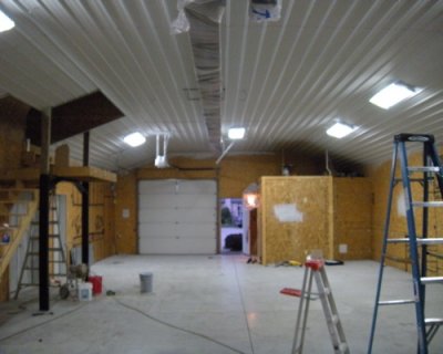

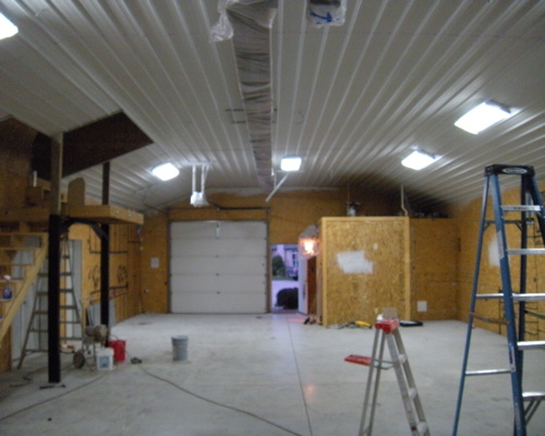

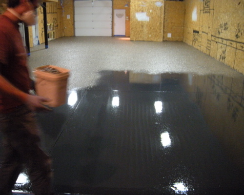

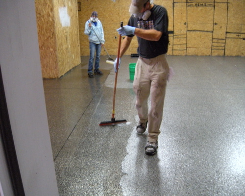

Since the '64 is done I've had a couple guys ask what the next project will be. Well, gonna do a shop upgrade. DW thinks it's a waste of time and money and that I don't need it; My reply is "It's not about need."

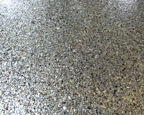

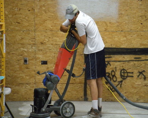

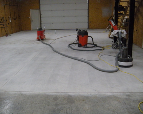

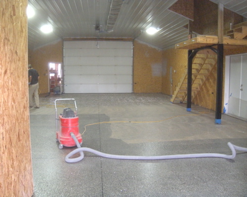

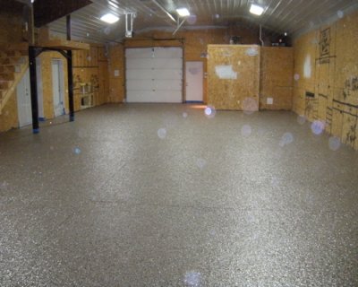

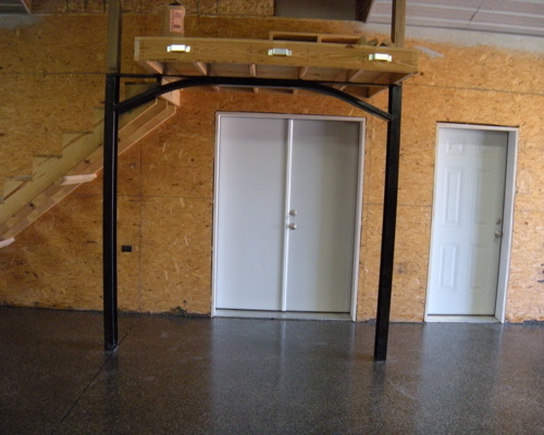

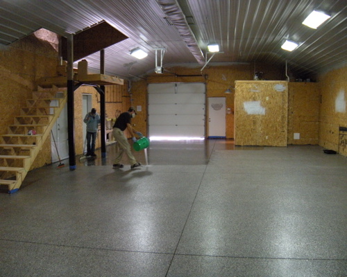

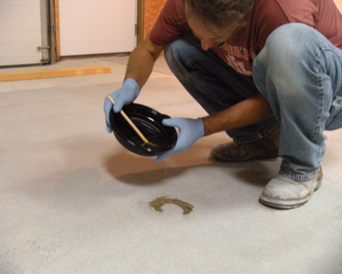

Cleaned everything out. ripped down the pad with diamond grinders. charcoal two part epoxy base. mica top coat. remove extra then pick up and buff the floor. then same two part top coat without pigment. Plumbing is done for bar area. cabinets are ordered. using galv. corrugated for the walls and shooting the ceiling with a heavy mica "aluminum" finish.
Will post more shots as we go. the guy you see in the shots is Rick Fischer of DecoIllusions. Very talented cat and a good friend.

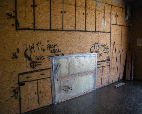

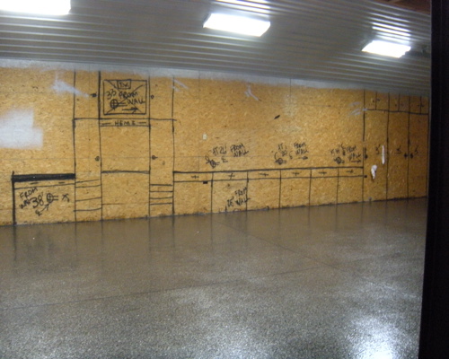

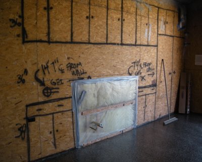

Funny story about the rattle can cabinet lay out. DW was rolling her eyes and hurumphing me about the quantity of cabinets, so I had to show her the basic scope of work; she is blonde but far from dumb and understood the use once I laid it out. One of the selling points (not that I needed it, but there is such a thing as domestic tranquillity) was that the "wet bar" area is "hers". The base cabinets will be file cabinet pull outs for her business files. The overheads are extra deep for all the canning supplies (pressure cooker, big kettles, jars, strainers, etc.) and the sink will be a single bowl 22x30 extra deep, to wash fruits and veggies. Then I'll install a low end commercial sprayer for the faucet. The large full height cabinets to the right will be for winter coats and boots, extra odd sized jars, pickling crocks and dry goods.

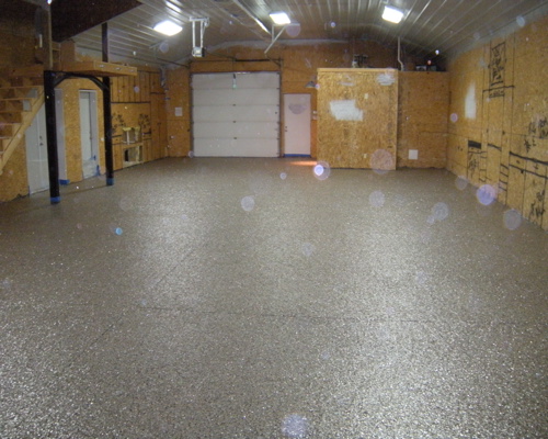

When we were planning this, Rick (Decco illusions) took me to a guys shop/business (40x80) where he did the same treatment on the floor with different color Mica. The guy is a taxidermist and he needed something that was bullet proof because of the salts, chemicals and traffic. He drives his skid-steer in the shop and pivots on a dime with no damage to the floor. The only damage he has is from where his brother-in-law pulled a pallet across the floor with nails sticking out. It scratched the top coat but Rick will just relay that area and you'll never know.

It's an interesting process. There is a point where you swear the only thing missing is Freddie Mercury, Liberace and Rip Torn. It's a little un-nerving until you remove the excess mica, buff it down and put on the top coat. Then it looks like Terrazzo.
Very nice, I am South of Ft. Wayne. What about cut & weld splatter on the finish. Jeff.

Thanks. Nope won't hold up to that; which is why I have the area behind this part which will stay concrete. Rick's studio is in Roanoake. he's on the west side of the main drag favoring the north end. He's almost never there as he is on a jobsite most days. i'd give him a call i'm sure he has options for your situation. Don't let the website fool ya, he get's into the job up to his elbows and is a car guy to the core.
