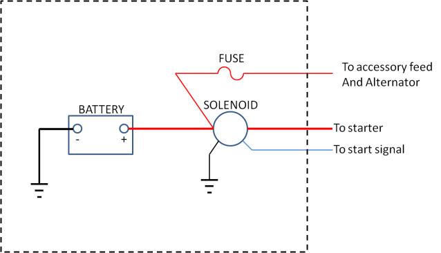

Thanx! Madelectrical has good stuff/info. Kind of archaic website though... I like the idea of the remote solenoid to keep the heat off the fat battery wire. I'll give then a call.
Amazing how those old, antiquated Ford solenoids never seem to become obsolete!

Ford? I thought it looked familiar. I see them all over when I searched for solenoids. Here's a basic schematic I whipped up. Batt Relocation.jpg
