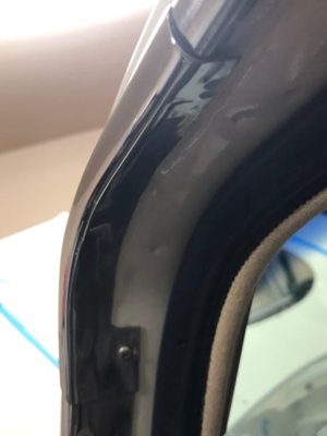

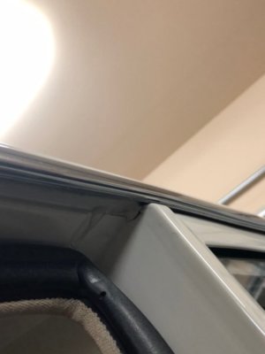

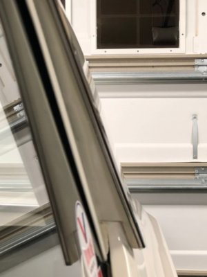

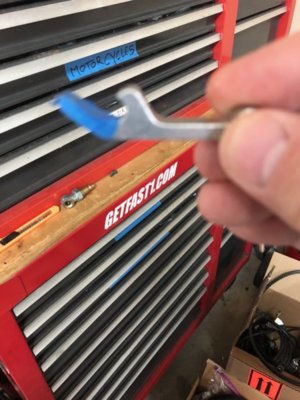

Guys,
Sorry for the delay. Have to work every now and then to support my Mopar habit! Anyway who would have thought something that turned out to be so easy causes so much angst. Anyway, I guess I have it easy because I have a Belvedere 1 and there are no clips! I did start out by watching the you tube video at the link I provided. But this guy is moving way to fast and it appears his main goal is to remove the trim only and not to remove and preserve! I had to do both so I went a whole lot slower (a whole lot slower) and made sure I did not damage my trim piece in any form or fashion. I will attach a few pictures here and I'll try to describe what I did to the best of my ability in the next post.
Oh yeah and for the install WD-40 (your friend), patience and your palm are all you need.
