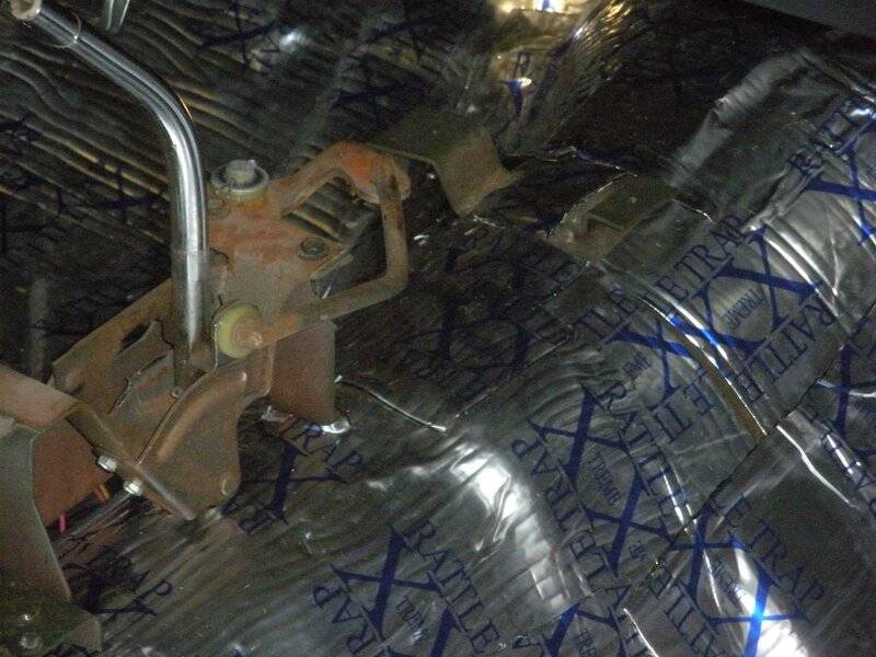

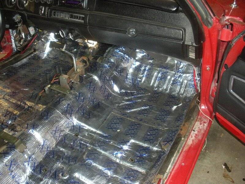

This stuff sticks quite well to bare and painted metal surfaces.
Years ago I pulled the carpet and laid down this stuff. It isn't actually the "Dynamat" brand, this was called "Rattle Trap".
Now I need to do some transmission tunnel work and this stuff needs to come up.
I imagine that colder weather may help with removal since the soft backing won't be as gooey as it would be in the Summer.
Are there any tips to removing this stuff? What about the black stuff that may remain after removing the foil? Alcohol? Acetone? Lacquer thinner?
