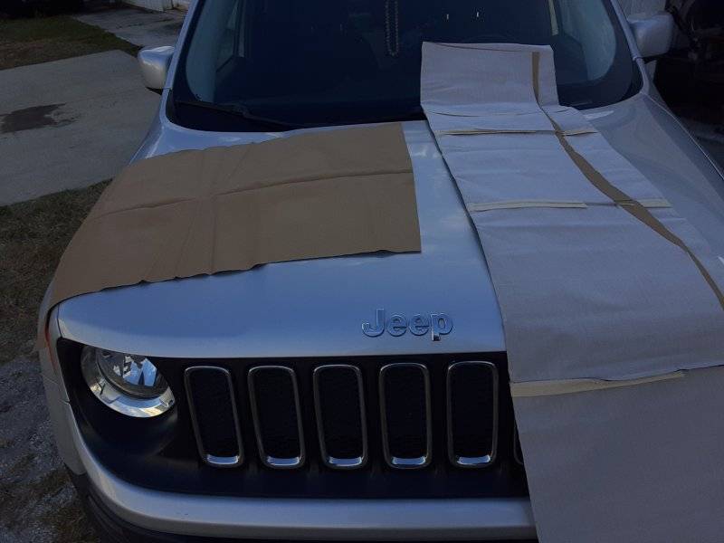

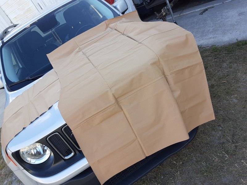

Looking to replace my headliner with the factory matching vinyl. SMS Fabric's has the matching gold color with the right texture but they have such bad reviews I am very hesitant to purchase from them. The interior color code is E6Y4. I believe the color is called Honey Gold. Having trouble finding a matching sample anywhere else I've looked. Any suggestions?

I brought one from Legendary a few years back. It was only available in NOS and took a year to get. Im talking pre covid.

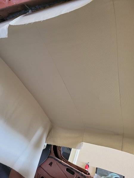

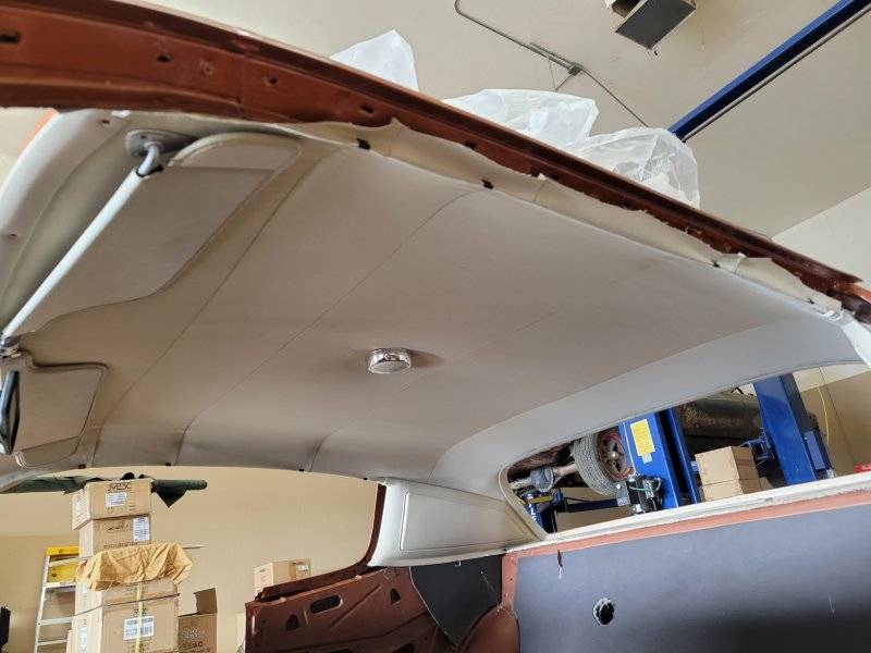

I have the Yorkshire cloth headliner and the only place I could find it was SMS. It took a long time to get it but when it did arrive it was perfect and had plenty of extra. Harder to install than vinyl since you cannot get the wrinkles out with a heat gun. Did not have a pic of the, final, final install I just kept working to get the wrinkles out. This was my first headliner ever. Lesson learned is to put the dome lamp screws in first and make a small slit to let them through. I messed mine up and was off by "that" much.
