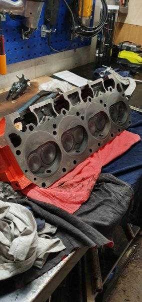

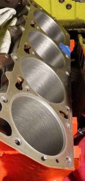

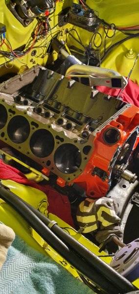

71 RR, alot of space. Just pull the intake and radiator. Had som issues with the dowel pin on my cam and while i was doing that i swapped the piston the rings and hone the bore with the block in the car! Worked out fine
Shoot, man...That is a backyard rebuild, not a cam swap!

Well, pretty much had it build on engine stand a couple weeks before that, got some issue's with smoke and so on and couldnt handle it and didnt wanna take it out again so. But it was a good thing i even fixed the heads and pressure tested the valveseats, anyway runs great now! So go for it wont take long!:)
