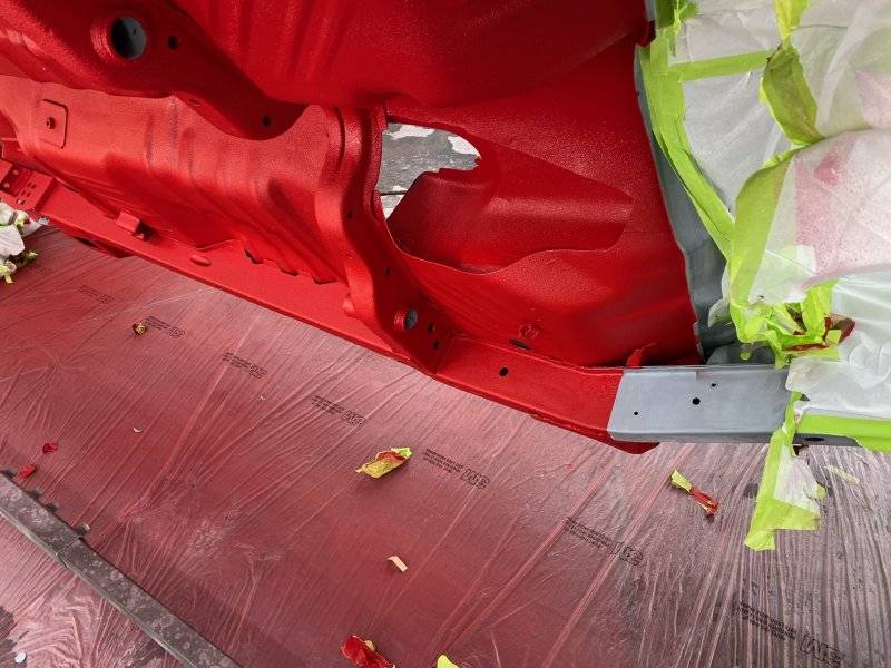

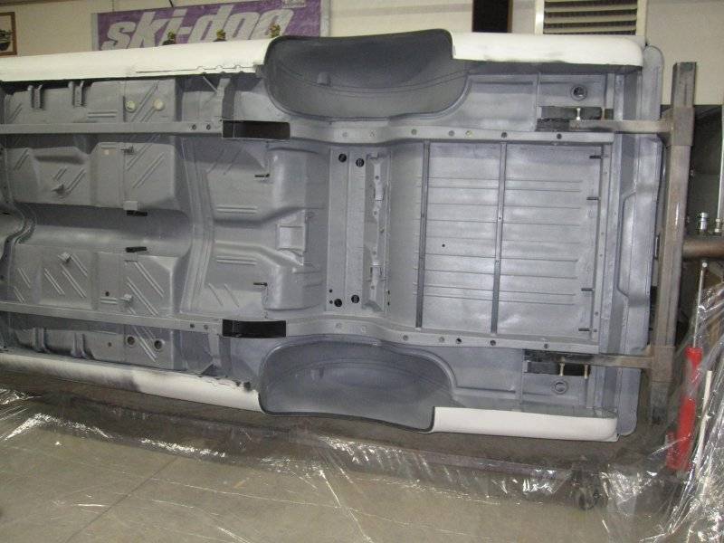

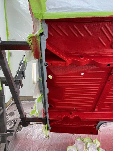

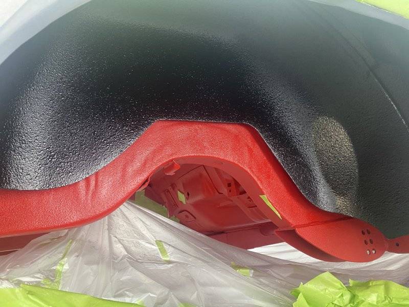

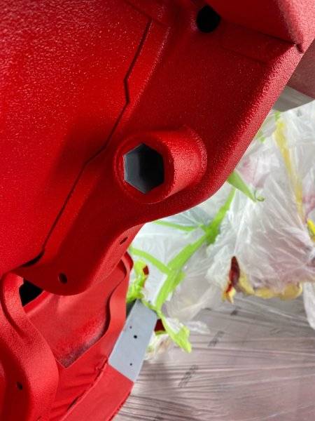

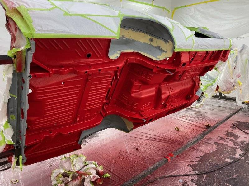

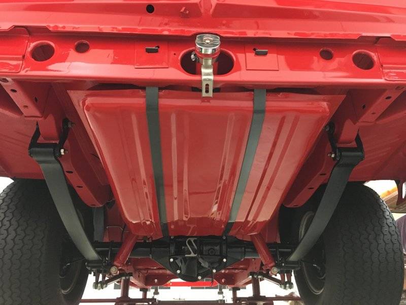

FWIW 4 quarts will not do a complete b-body underside from firewall back. What you see below is 7 quarts - one coat. Also, it really needs to be applied in a short window otherwise it needs to be scuffed before another coat can be applied. Do all your gun adjustments then shoot it in one coat. This was the "tintable" Raptor Liner and is a perfect match to the body color. For reference, the black is rubberized undecoating and both have the same texture.

Why in the world would you want an orange textured underside of your mopar?
A lot of guys fully paint the underside body color and the Raptor liner gives it better protection from dirt, rocks etc. so why not? If I wasn`t going for the factory look I would do the complete underside of mine.
I have always used Rick's stuff, but from the pics above, that Raptor looks decent as well.
I used the tintable Raptor in gray to go with the silver on my 65 Belvedere. Easy to apply, I used 2 coats.

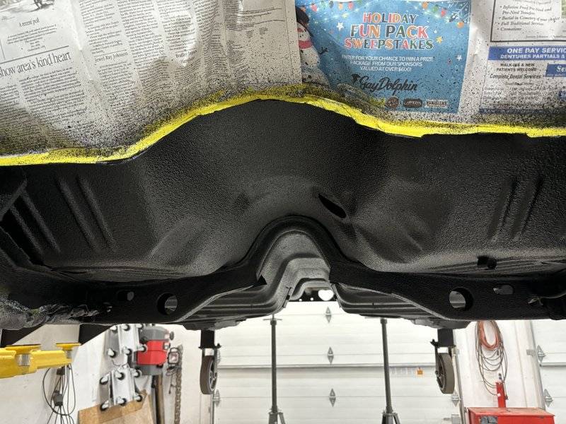

Sprayed mine in 2011 with Herculiner and still looks the same to this day. I adjusted the air pressure to copy like the factory and believe me I know. This car had factory undercoating and I scraped it all off. Pic is not super clear
Looks good I like the match I just have seen it on a complete car colour match.
