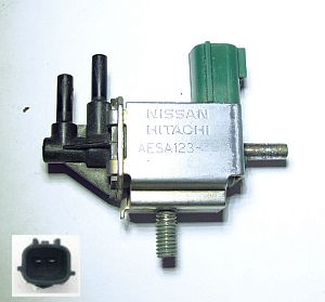

Gotta question for you guys, I'm cleaning up my vacuum hose mess and will be going to a vacuum solenoid to operate the headlight doors (only one visible hose and no more expensive headlight switch). I've been looking at 4X4 vacuum solenoids and EGR vacuum solenoids that would be auto part store available and want to find what would work best. With the 4X4 valve I'd have to run two, one to open and the other to close but I'd like to use one that does it all. Here's a few pics, the Nissan one has what looks like three ports so I was wandering if it had two functions meaning one would do it. Anybody have any idea's. egr valve.jpg4X4 vacuum solenoid.jpg

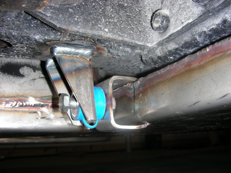

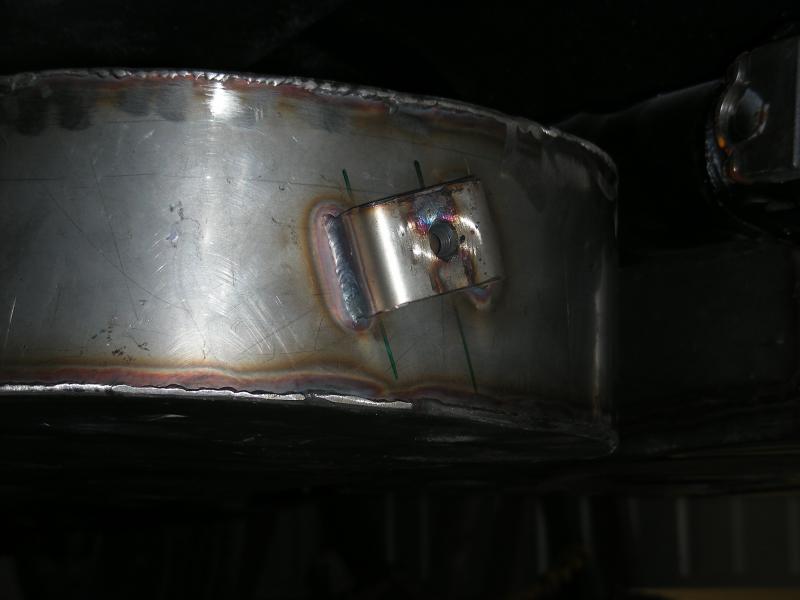

I've been MIA on my updates because #1 I'm waiting on another cam and lifters, #2 I've been trying to finish the wives car, #3 I went off and boogered my back up again. Only progress on the Charger has been muffler brackets "woopy". Good news is Comp stepped up and will be sending another cam and lifter set, a touch more aggressive and solid "no more @#%&$#$ ticking (well kinda)" also finished the Jeep tranny and got the money for my clear coat "I can smell the paint now". Not sure when I'll paint it, I still need to find someone to make the stencil for the Super bee style stripe and do a little work on the booth.

Thanks, but I really don't like all of the hoses going everywhere and want to clean it up. Thanks cdr

And sorry to hear about the spot of bad luck 747, hope everythings going well with fixing up the pipes and shop. I'm also not sure on the vacuum solenoid but I would think that Nissan one would work.. :thinker: are you just gonna wire it to an auxillary on/off switch on the dash or somewhere? Hope you have better luck with the new cam and lifters, that's pretty cool that Comp are giving you such good customer service trying to get everything sorted out

It's all good, things like that make you really appreciate the good times which I'm sure are about to come. Haven't fixed the pipe yet, for now I dug out around the corners of the garage to let it drain, to fix it right I'll have to cut the concrete "not a good idea with my motor opened up". As far as the headlight doors go, I'll tie the solenoid into the high and low beam wires with diodes to keep them from back feeding (solenoids usually only pull 1/2 an amp or so). I talked to Comp again, should be here by the weekend but this weekend is the Mopar Nats so might not have as much time as usual. Let me know if there is anything you want me to look for at the Nats "tons of goodies in the swap meat".

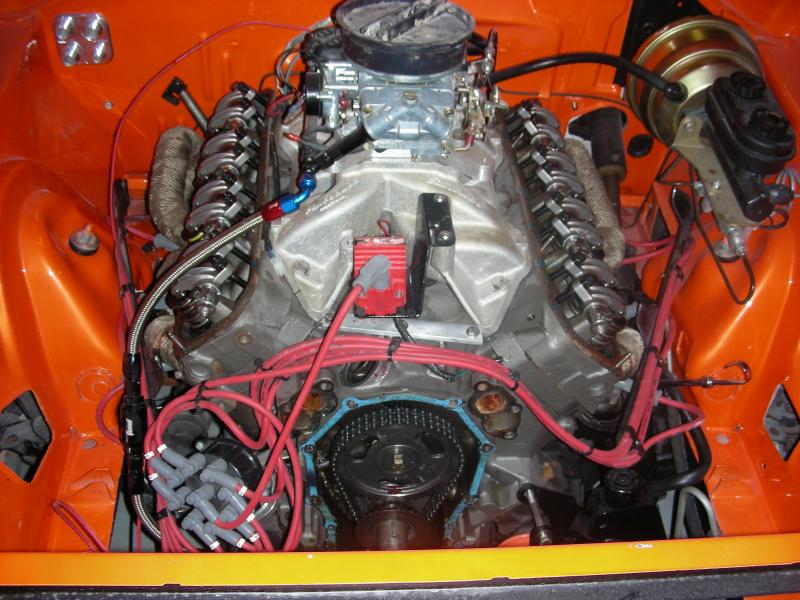

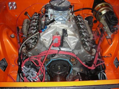

New cam and lifters came today so I'll likely put it back together tomorrow night. Never installed a solid lift cam except in my tractors but don't figure it will be any different, probably set the lash while the degree wheel is on to speed it up a bit. I also think I found someone to make the masking for the Bee style rump stripe, once I have it it will just be a matter of going back over it again and then paint "finally". There is one other issue one of may be able to help with and that is the trim clip locations for the rear window, I put full quarters on and the originals were so bad that I couldn't get most of the measurements from them. Did I mention my wife hit a deer with the Aspen yesterday "that's three for three" she's hit a deer with every car she's had since we were married haha. No biggie, cracked the grill. I was thinking about putting deer whistles on her cars but it developed an exhaust leak so maybe I'll go one better and make it sound like it has a Hemi now.

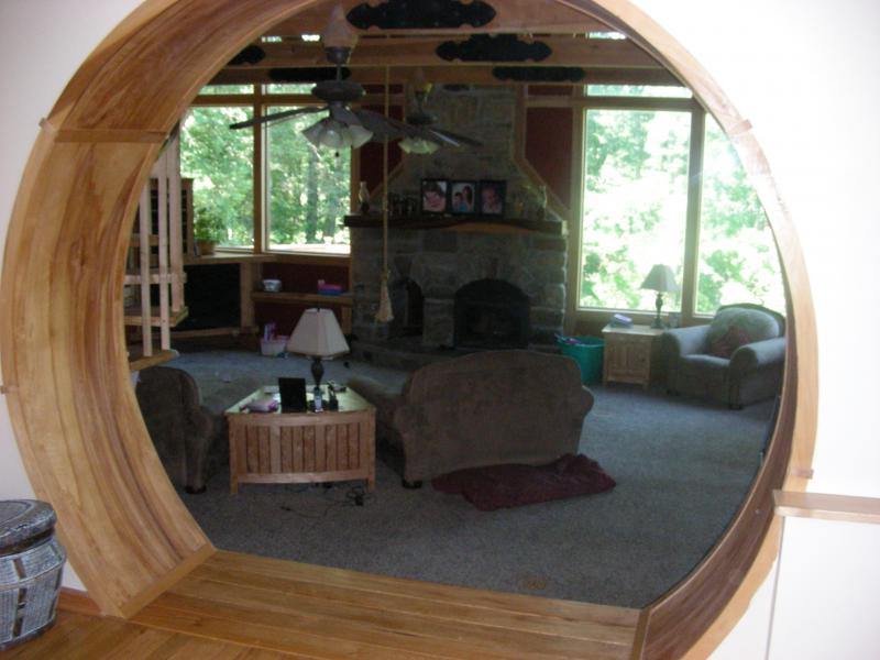

I don't remember seeing that picture the last time i was here man, You have a beautiful home 747, that is a lot of space to keep warm, We don't have a fire place hear although i can open the door and place a screen in it when we like the atmosphere, winter wiener roasts with marshmallows lol.. My grand daughter introduced me to "Spores" if im saying that right one night at our fire pit, graham crackers with hot marshmallows and chocolate melted between them, new to me anyway but heck, im sold im not supposed to eat that kind of stuff but cant let my girl down right? :) besides, they were good! lol

"Smore's" Love em. Your correct, I couldn't find the pic when I made the post so I added it later. Feeling much better already (hanging upside down like a bat seams to help). Take care Ron

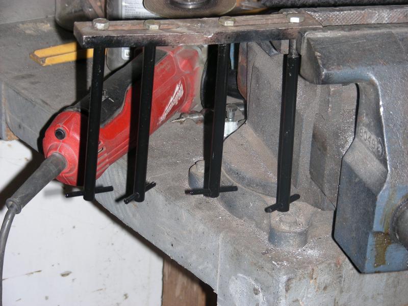

DSCN8290.jpgDSCN8286.jpgDSCN8276.jpgDSCN8277.jpgDSCN8281.jpgDSCN8275.jpgThanks cdr, that will help. If you could, would you give me the measurements for the top "really hard to make out". I hope they sell a kit with all of the parts so I don't have to buy all the individual parts.

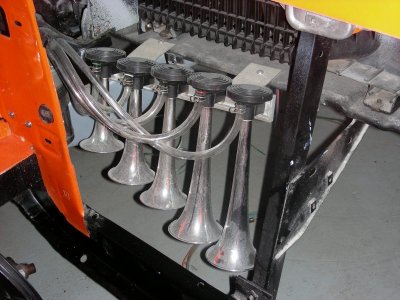

Didn't get what I wanted done tonight but did get what I expected done "Mopar Nats in the morning can't stay up to late". Cam, lifters, pushrods and rockers all cleaned, oiled and installed, tomorrow night I'll degree it and hopefully have it all back together. I figured while the radiator was out I'd shoot a pic of the Dixie horns, come with a single bolt hole that lets them go all over the place so I machined an aluminum bracket with pockets "not moving", can't see them when it's all put together. I know allot of you hate hearing General Lee from people when referring to your Charger but I'm sorry I love that horn and it puts a huge smile on my daughters face (Dukes fan). Also got my muffler brackets done last week, not super happy with the rear bracket but can't find anywhere else to support the inside of the mufflers so they don't sag (good thing I fabbed a second exhaust bracket while I was at it, mine was a 318 car). After pulling the valve covers so many times I finally got sick of fighting the two outside bolts (not much room for a 7/16 socket with these thick valve covers) so I made a set of T handle nuts. That's it
from right to left the tape end is in line with the sail panel top edge,3,,,,,9 3/4,,,16 3/4,,,,21
yes they sell a kit
front http://www.rtspecialties.net/proddetail.asp?prod=1000045A
rear 1000045B REVEAL CLIP SET REAR 68-70 CHARGER
REAR ONLY
Thanks again cdr, I'll have to get them ordered.
