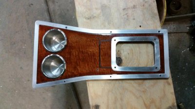

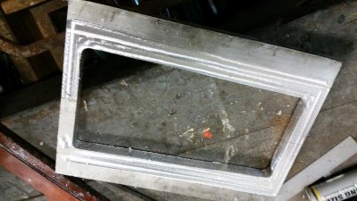

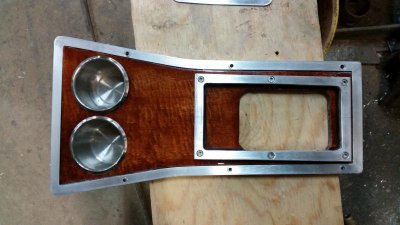

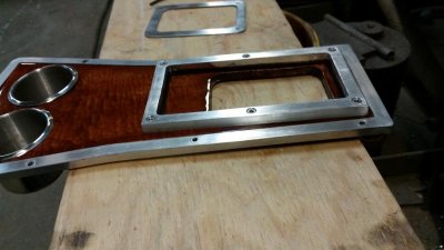

Getting close to wrapping up the interior, all that is left is the new console top plate. I've got it done, all stained, cleared, sanded and buffed and got the shifter boot trim made tonight. I started off just cutting one out of stainless but it looked like a cheap Autozone one so I milled one out of aluminum (much better). Also took the time to go over my pinion angles using a cool App from Tremec and ended up shimming the tail shaft up 3/8" to get it all in the GREEN.
The cheesy stainless one.
The milled aluminum one with countersunk stainless bolts.

Both the stainless and aluminum looked good to me but agreed the aluminum does look better! Looks like you had another productive night Dev!

So cool to be able to fab your own custom stuff like that! I am really looking forward to seeing a final shot of the interior.
747.......console piece is tight...elegant. picked up on the Jefferson quote

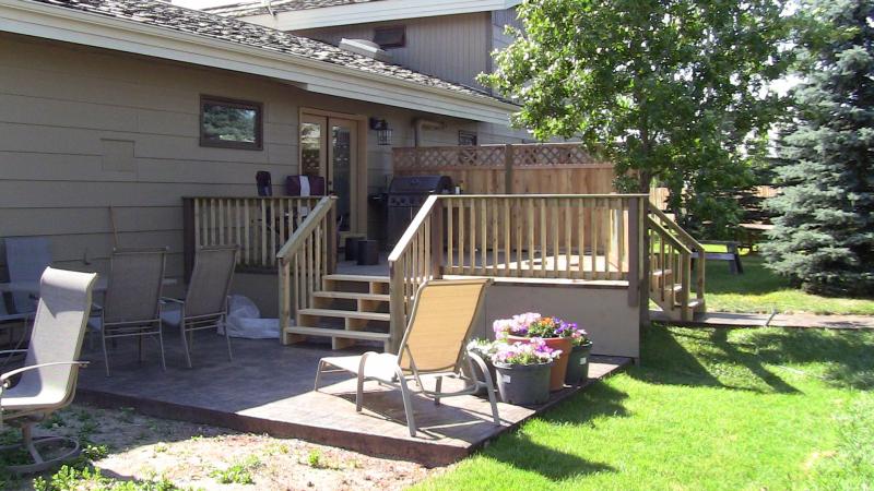

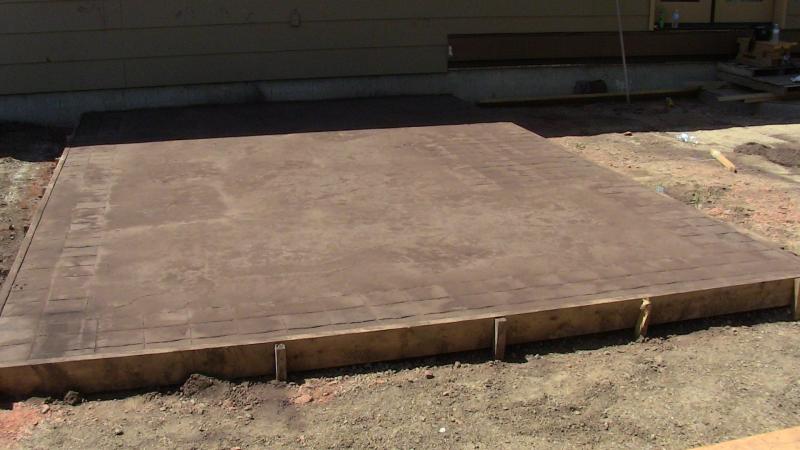

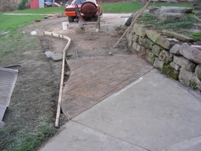

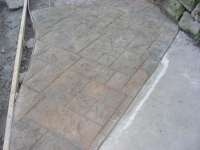

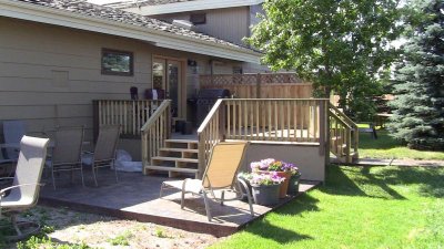

Here's what will be eating up my time for awhile but I'm happy to do it, my wife has put up with allot from me and the Charger haha besides I enjoy building just about anything. I had a buddy that has already done the decorative concrete come out to do the first pour to get me started but I'm on my own now. I'm doing it in short pours for 2 reasons #1 I'm mixing the concrete myself so I can color the concrete (time consuming to do after work, #2 Doing this will mean I won't have to cut expansion joints. It's a pretty cool process, mix and color the cement, float and trowel it off, sprinkle a release powder over it that actually partially stays in the cement to add an antique look, place the thick heavy rubber stamping pads on it to give it the appearance of stone and rinse it off the next day.DSCN9993.jpg

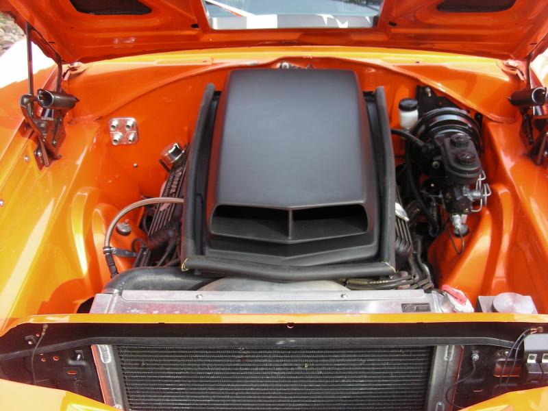

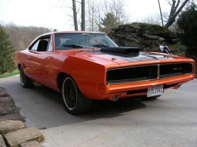

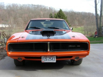

Here's a few pics of the Charger, it's been a bear keeping it clean with the never ending rain!

747's 'Tangerine Dream' eh? Seductive...love the color key...very tasty & understated inset in hood. House of Kolor.....yeah looks like a few thousand hours to me.....93 pages of thread seem to indicate that too. adds to my inspiration to get my deal launched..... ...Did You do Your own straightening/refinishing? Car has bitchen' presence.....nicely executed....Salude' Dashwork sweet and the steering wheel choice is right down the slot.
You are going to love the sidewalk. I did a deck, patio and sidewalk last summer. A lot of work but it is beautiful now! That releasing agent gets everywhere, literally.
Oh, the car looks awesome too!!

Very nice Grill, when it's all done it will extend into a paved parking spot for the Charger too. Just not having to deal with weeds growing threw the sidewalks and parking spots alone will be a real improvement. Yes that crap gets everywhere, I have to walk all the way out and around this area to avoid tracking it into the house.
Thanks Bladecutter, Yes I did everything on the car myself unfortunately haha (lot's of work) but hey I couldn't afford to farm anything out. I tried to walk a fine line between customizing it to my liking but keeping it very much a classic Mopar at the same time so it's always nice to here someone liking it. Glad to here your getting motivated to get yours underway, what are you working on?
