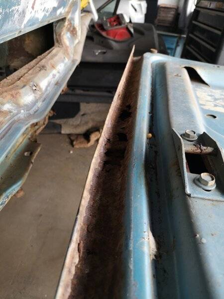

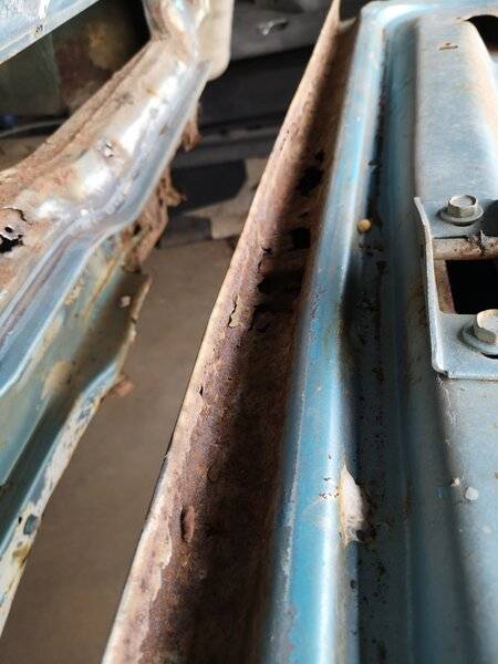

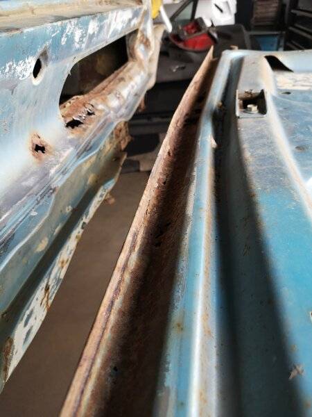

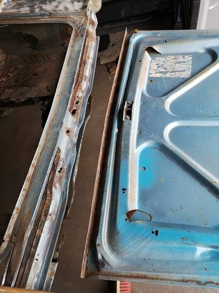

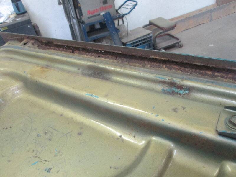

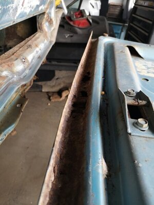

as you know since a few weeks i startet with my restro.... so far so good, no big suprises.
I am just struggling with my trunk lid .... not sure how to rescue the lid ?
THe lid is in a very good condition , unfortunaley just in one area its completely rusted through... details see attached pics..
What do you think ... what is the easiest way to get this done ? ANd i dont mean to call AMD ;-)
Looking forward to ur feedback
CU
Achim
IMG_20200711_181359.jpg IMG_20200711_181408.jpg IMG_20200711_181412.jpg IMG_20200711_181415.jpg
If the outer skin is solid, you could grind the fold over thru and cut the reinforcement up into the unrusted area and remove the rusted section. Then fabricate (or hire someone to) a replacement and weld it in. If the fold over piece of the outer skin is wanted, a strip of metal could be welded to the skin to simulate the appearance or just weld the bottom rear edge of the outer skin to the new piece and metal finish the weld. I hope you understand my description?
Mike
Hy all !!
CU
Achim
View attachment 974250 View attachment 974252 View attachment 974253 View attachment 974255
Mike
That is a very fine description Mike, of what he needs to do! I couldn't have said it better!
I just hope that he can fabricate, or find a person that can do it. It will definitely be a big
and very timely job. Just go slow, and do not be in a hurry!! Good luck with your trunklid!

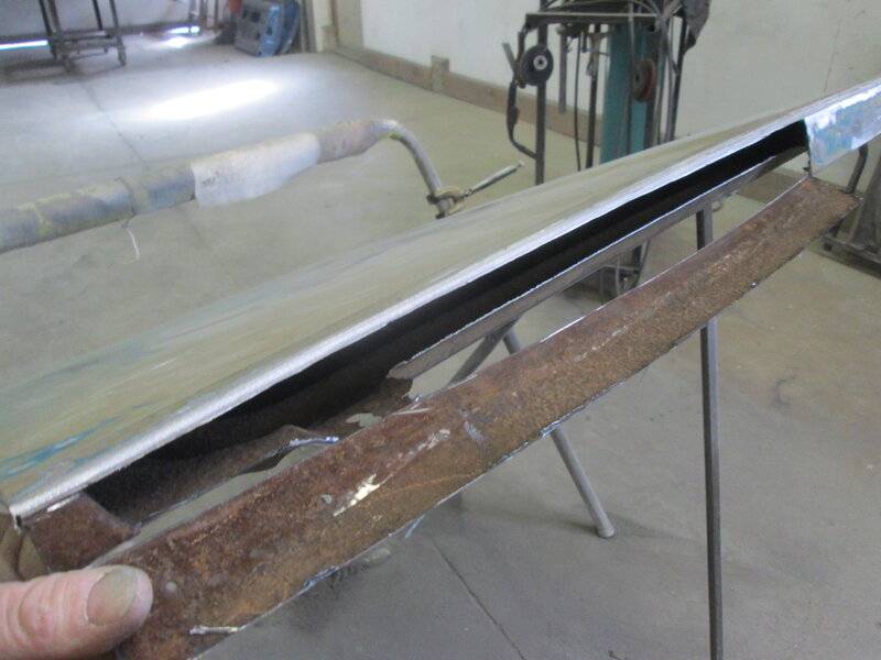

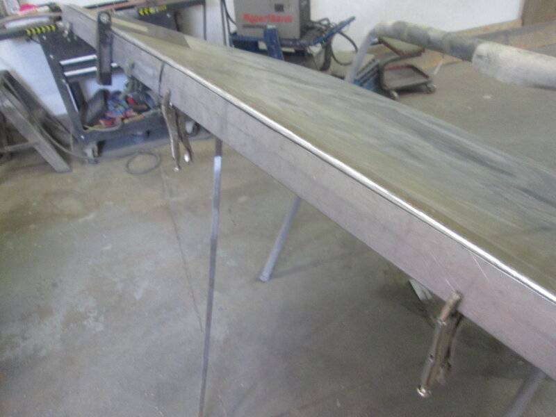

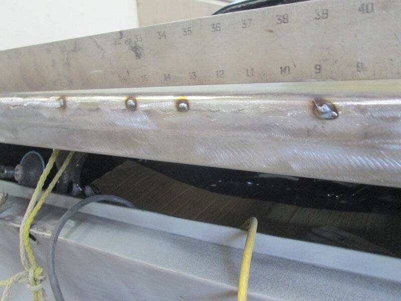

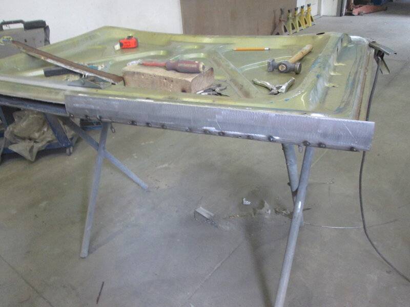

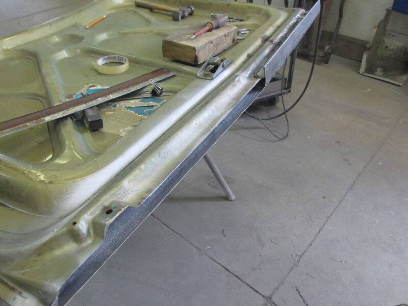

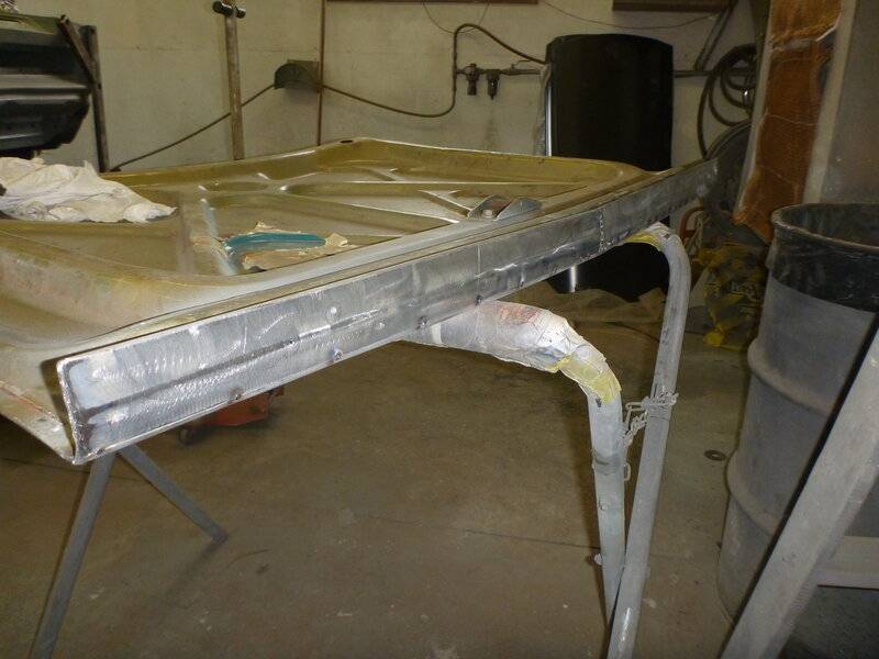

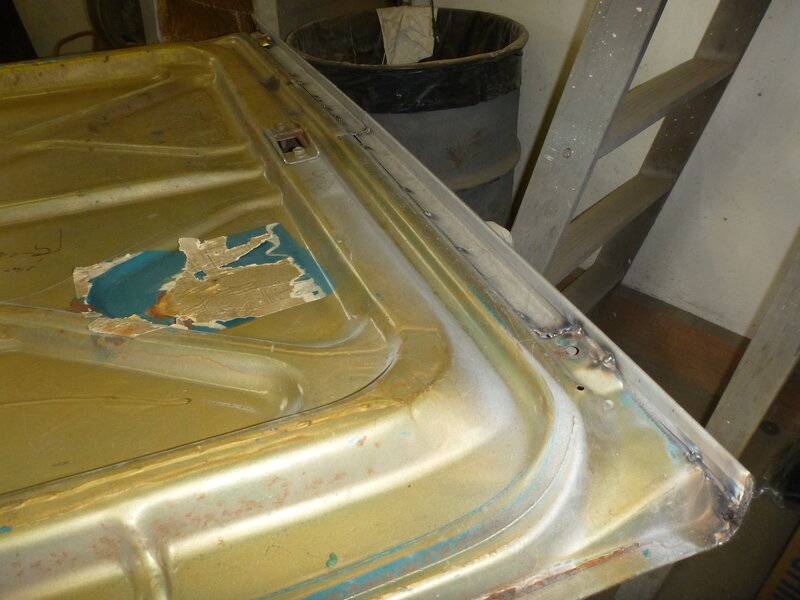

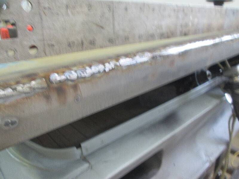

Make patterns/templates NOW... take measurements from everywhere NOW.. put a straight edge across it and see how much bow is in it to each end NOW. Then cut the crap out and replace it..

thx for ur great advice.....!!!! luckily the outer skin looks almost perfect... so i understood ur description and will grind of the fold over part...
Are there any spot-welds ???? or only fixed by fold-over ?
THx
AChim

WOW! No one could ask for a better answer to the OPs question.
