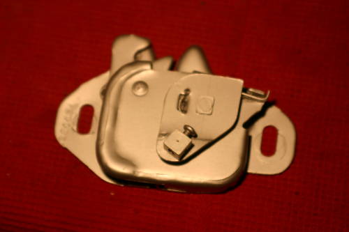

Hood latch
How would you suggest cleaning up a hood latch?
I am a little concerned that acid might harm the internals
and blasting might lock up the internals
This is an example of a cleaned up one
