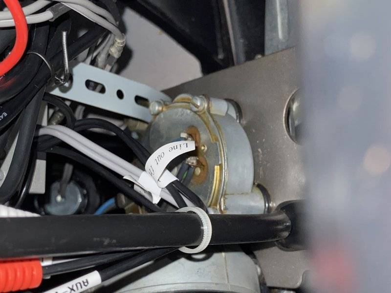

I just installed a RetroSound unit in my 65 Belvedere. The Motor 4HD unit has Bluetooth among a lot of other features. Google RetroSound. I don’t run a separate amp. I run two 4-way 6x9’s in the back plus two tweeters in the center front speaker position, off the radio amp plus a powered 8” sub in the trunk. I like the sound but I haven’t run it while on the road yet - I’m still debugging the car as I just got it running 3 weeks ago and don’t have it aligned yet.
Post 65 in my build thread shows a few pics of the RetroSound unit I bought.

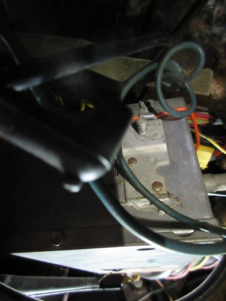

How did you guys support the head unit in the back? I'm looking for a place to attach the included brace but the windshield defroster duct is right above the head unit. I might be able to go further back into the dash and drill into what looks like another duct under the windshield. It would be nice if there was an existing bolt I could put the brace on.

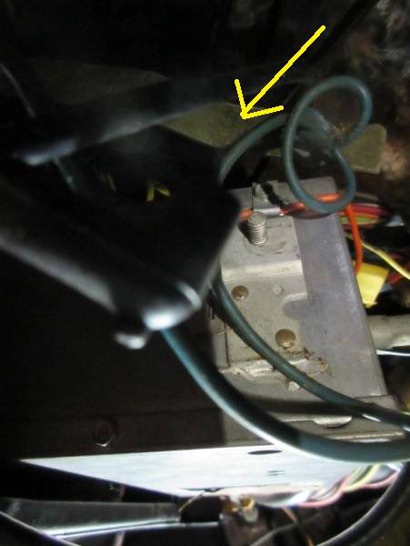

It seems like this stud on the side of the factory head unit went to a supporting brace, but I don't see one under the dash -
In this pic, you can see the shape of a bracket around the stud. What went there?

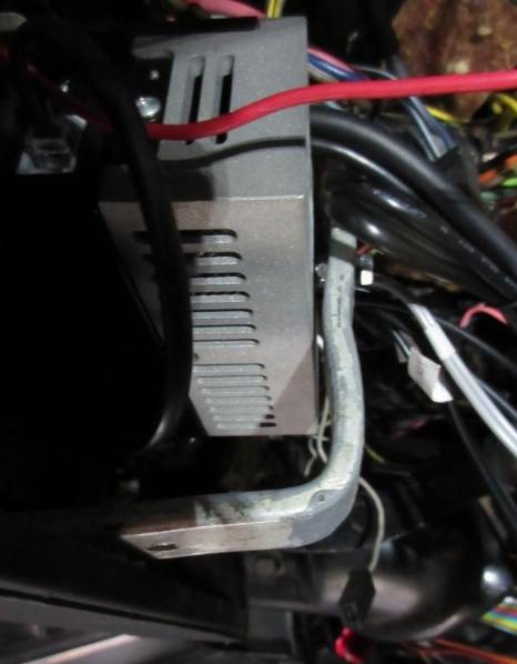

I'm considering supporting the unit from below. At the moment I've got a bunch of foam wedged between the head unit and the dash, which would be fine if not for all the cooling holes in the bottom of the head unit. I could cut the top and bottom off a pill bottle and use that as a wedge. It might squeek and rattle or wear the paint off the unit over time. If no one has a better idea, I believe I'll give that a try. If I look around the garage, I may even come up with something better. I've often had a piece of junk I stored away for no good reason suddenly, after being in my way for years, turn out to be just the thing I need right now.

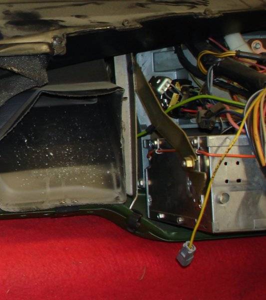

Is that not the original radio support strap in one of your pictures? Under the windshield? The plenum? I wouldn’t be drilling into that.
View attachment 1561281View attachment 1561283
Well that makes all the sense in the world, doesn't it? So where does that green ground wire for the instrument cluster go? The one I have incorrectly "grounded" (or not grounded, no wonder I'm having ground issues!) to the bracket for the radio?
I thought I had cleverly solved my mounting problem with an L bracket that I found -
- that will work fine, but maybe there's an even better way to do it.
After inspecting the bracket I have a ground on, it does indeed appear to be a ground. There' s an S-clip for the pictured screw over the hole that the radio used to use. I wouldn't have put anything like that in place, not by accident anyway.

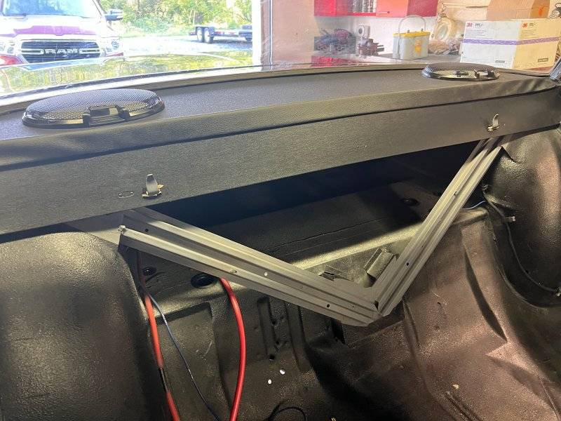

I wired the front speakers to the output cable for the Retrosound head unit today. The speaker wire was 16 gauge, but the wire coming off the head unit is 18 gauge. I'm surprised to see the head unit use 18 gauge wire, when Retrosound's center dash speaker uses 16 gauge.
I also managed to run one 16 gauge wire to a rear speaker negative terminal. I've got a role of 14 gauge which I recall using to wire door speakers on another car. 14 is a lot bigger than 18. I don't know if I should use the 14 for the rear speakers or not. There must be a reason why I was told to use it on the other car, and I wonder if I should go to a separate amp would I need a 14 gauge wire? I sure would hate to have to tear the interiour out again to put a 14 gauge wire in, if I used a 16 now.
BTW, does the wiring for the passenger side rear speaker go down the passenger side of the cab, or cross over in the trunk and run down the driver's side of the cab?
Best practice is do not run power wires and speaker wires together. If you have power running down either side, run speakers wires on the other side.

The factory support bracket lined up perfectly with the rear panel mounting stud on my Pioneer single din CD player..
There was never a true stereo rear speaker configuration from the factory. Speaker level signals are not susceptible to induced noise, run speaker wiring wherever you want. Line level signals/cabling should be routed away from any heavy loaded power cables to prevent induced noise.
I didn't put that clip and screw there. Is it possible the radio stud sits in the notch above the ground screw? I'd love to see what other 72 owners have.
